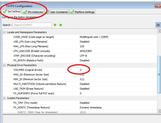

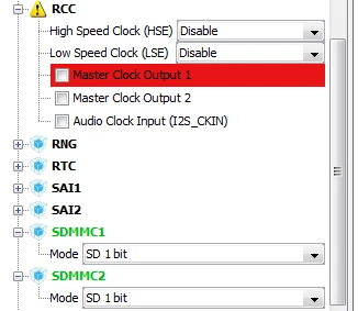

This is continuation of below Topic.
I have
/external-link.jspa?url=http%3A%2F%2Fwww.st.com%2Fen%2Fevaluation-tools%2Fnucleo-f722ze.html
And Trying to access Two microSDCards Simultaneously . One by One (Either SDMMC1 or SDMMC2 is working fine)
https://community.st.com/0D50X00009XkWKfSAN
Below is my STM32Cube Configuration Setting
Rest all default .

With above code I can only access one microSD Card Only.
I am not able to access both micro SDCards simultaneously . By Added Drive number .
Please help me to resolve this ..
Thanks In advance .

    Tesla DeLorean
    Guru
    Jul 11, 2018 3:30 PM UTC
    Posted on July 11, 2018 at 15:30
    Would take several hours to create a working example, I'm open to reasonable offers.
    Karan 123
    Karan 123Author
    Senior
    Jul 26, 2018 5:38 AM UTC
    Thanks .. Worked...
    I have created new &SD_Driver_2 in diskio.c Now Both SDCard working fine ..
    const Diskio_drvTypeDef SD_Driver_2 =
    SD_initialize_2,
    SD_status_2,
    SD_read_2,
    #if _USE_WRITE == 1
    SD_write_2,
    #endif /* _USE_WRITE == 1 */
    #if _USE_IOCTL == 1
    SD_ioctl_2,
    #endif /* _USE_IOCTL == 1 */
    Thanks again
