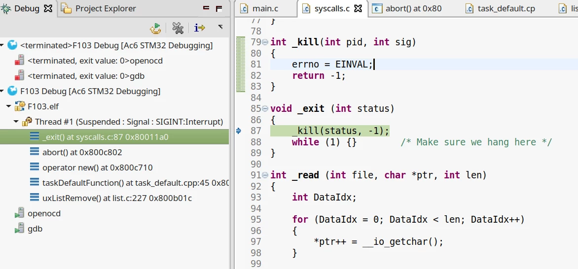

After updating CubeMx from 4.27 to 5.0.0 I ran into trouble regarding the newly created module syscall.c:
  • compiler error (had to switch the C++ dialect settings from "-std=c++0x" to "-std=gnu11" to fix it)
  • but firmware is now not running - it stucks in function _exit() caused by a new() operator
How can this be fixed ???

    Have you found why operator new fails? Pool size too small? The _exit() hangs exactly because it's coded so.
    -- pa

    Thanks for pointing me into the right direction. Indeed the heap and the stack pointer are interfering.
    Now the question is why this issue was not occuring while using the C++ dialect -std=c++0x ... :\
