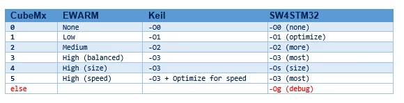

    In CubeMX, we don't have the interface to handle this parameter yet and we handle only the default value.
    However, for the moment, you can change manually in the ioc the ProjectManager.CompilerOptimize value with one of the value below :
    It is planned to integrate this functionality but, unfortunately, I can't give you any target date for the moment.
    BR. Jeanne

    Setting
    to 4 ends with fr.ac6.managedbuild.gnu.c.optimization.level.size in .cproject with STM32CubeMX 4.24.0. It did not worked with 4.23.0.
    But it does not work for all values.
    =2 gives fr.ac6.managedbuild.gnu.c.optimization.level.debug.
    Regards.
