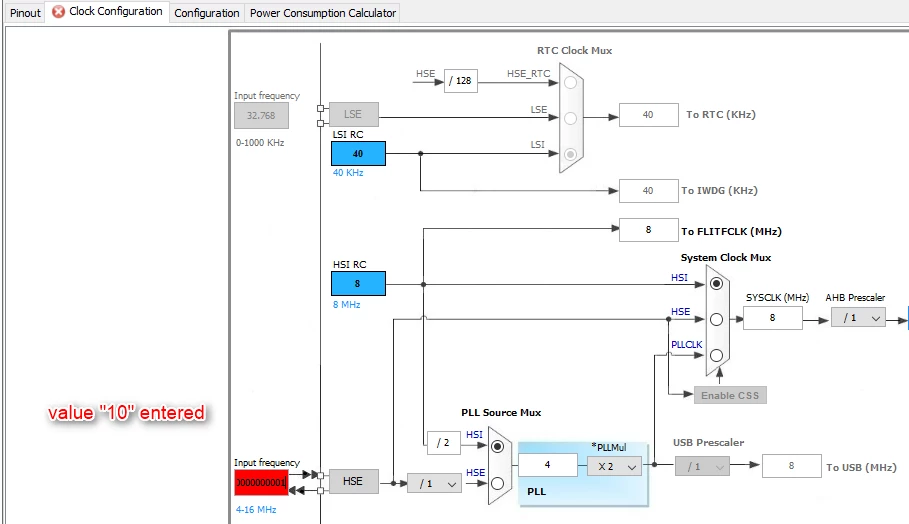

The Clock Configuration GUI shows a weird behavior: I'm not able to put a valid input frequency for HSE (or LSE).
For example I want to setup the input frequency to 8 MHz:
  • entered value 8 is not accepted - changed to 0.0000000000080 immediately0690X00000606ogQAA.png
  • entered value 8000000 is accepted and changed to value 8 but as soon as the focus is changed to an other element the value jumps to 0.0000080 0690X00000606qCQAQ.png

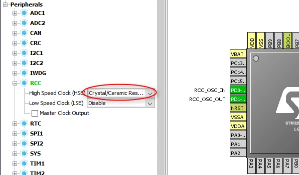

    enable High Speed Clock

    but as soon I change the default value the GUI shows wrong values
    clock values entered in Hz (e.g. 10000000) are temporarily accepted as 10 MHz but as soon as I change the focus (activate another element) the entered value becomes invalid.

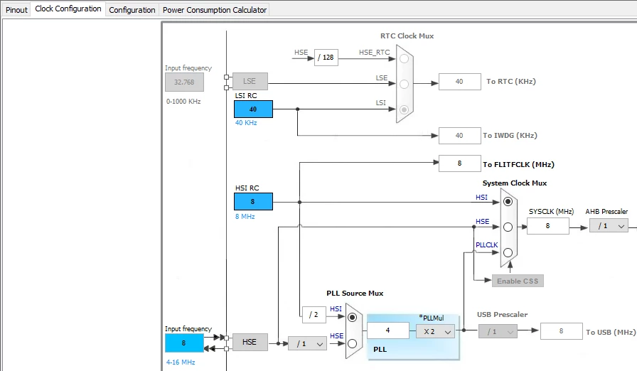

    Hello, had the same issue but found a workaround:
    the gui erroneously validates the frequency input dividing it by 100000 and rewriting the divided value to the textbox: this is the bug.
    So,
    you don't have to press enter
    once the crystal frequency is entered (in Hz) into the textbox, but
    simply move the focus to another component on the page (a prescaler combo, a radio button, whatever else).
