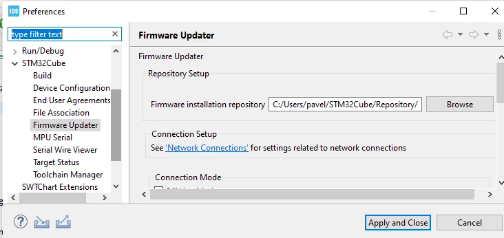

    Please open Window->Preferences and then open the repository folder in Explorer
    0693W00000GZYzgQAH.pngDo you see there subdirectory named STM32Cube_FW_H4_V1.26.0 or STM32Cube_FW_H4_V1.26.2 ?

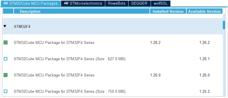

    The current situation is :
    • I have the package installed (manually by downloading the zip file on the product page) then by using the "From local..." button in the embedded packages manager. This gives me the following :0693W00000GZb9OQAT.png

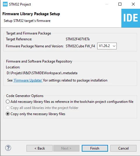

    • But when I try to create a new project :

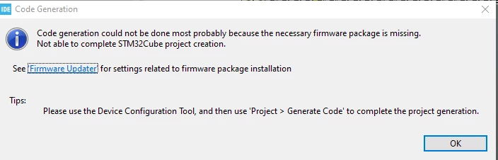

    • I always get this error : 0693W00000GZbAgQAL.png
    I tried installing also manually the zip files (by unzipping it in the repository) this doesn't work either.
    I tried to remove all packages and let the wizard download and install, this doesn't work.
    I have no clue on what to try next
    MM..1
    MM..1Best answer
    December 1, 2021
    Check if instalation repository paths is without spaces, reinstall IDE without spaces or special characters in user name usw...

    Ok I uninstalled the whole IDE and reinstalled it in the C root drive :(
    and now it works.....
