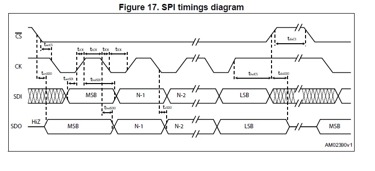

    Well, because I had some issues debugging the old project that I built with GCC/AC6 toolchain, I had no way to find what's going on on the registers level. I just managed to build a new project based on the SPL 1.7 with uVision so I can debug and see what's going on. I noticed that the RXNE flag is never set, although I'm getting the data back from my slave without any problem.
    Anyways, as far as the SPI Communication is concerned here, and from what I understand, the device goes inactive when CS forced high, which puts the SDO (MISO) in High Impedance state. According to the datasheet of the device, the communication starts when CS is forced low and the output (SDO) is latched on falling edges of the clock. This is shown also in the following timings diagram:
    As you can see, CS is forced high for certain time (tdisCS) then low again to start the reception of data. This is how the SPI is supposed to work across all similar devices. Even the CMSIS implementation for SPI follows the same rules for sending/receiving. But, what I don't understand here is the following function that is still doing the job and getting the response back from the slave. I just don't understand how the response byte is being shifted or read back from the device, while the CS is forced high? This is the function:
    uint8_t dSPIN_Write_Byte(uint8_t byte)
    /* nSS signal activation - low */
    GPIO_ResetBits(dSPIN_nSS_Port, dSPIN_nSS_Pin);
    /* SPI byte send */
    SPI_I2S_SendData(dSPIN_SPI, byte);
    /* Wait for SPIx Busy flag */
    while (SPI_I2S_GetFlagStatus(dSPIN_SPI, SPI_I2S_FLAG_BSY) != RESET);
    /* nSS signal deactivation - high */
    GPIO_SetBits(dSPIN_nSS_Port, dSPIN_nSS_Pin);
    return (uint8_t)(SPI_I2S_ReceiveData(dSPIN_SPI)); // Here the response is read while CS is forced back to high.
    Could someone elaborate more on this? How and when the response byte is supposed to be shifted out of my slave? And how the SPL-based function above returns the response from the slave device (dSPIN) while the device is ''UNSELECTED'' by forcing CS High??
    Thank you again for your help!

    T J
    Senior III
    March 25, 2017
    Posted on March 25, 2017 at 02:14
    to receive a byte you have to clock it, to clock the receiver, you have to send a byte.
    void quickSendReceive8SPI(SPI_HandleTypeDef *hspi){
     while( !( hspi->Instance->SR & SPI_FLAG_TXE));
     *((__IO uint8_t *)&hspi->Instance->DR) = TxSPIByte; // force the SPI to transceive 8 bit
     while( ( hspi->Instance->SR & SPI_FLAG_BSY));
     while( ( hspi->Instance->SR & SPI_FLAG_RXNE))
     RxSPIByte1 = hspi->Instance->DR; // empty DR fifo, we only want the last byte
    as you can see here, I am clocking out TxSPIByte, to clock in data, if there is some earlier data in the Rx buffer (usually double or tripled buffered) then the final byte received is left in RxSPIByte1

    Just a quick update, the RXNE flag sets now as I send a new byte to the slave. The slave responds with 0x00 for most commands received, except those required to read parameters from the internal registers. Well, that was on the old version of the project I built with SPL.
    As far as I remember, I tried everything possible, even the Send_Receive in order to clock data into the receiver. But I might have missed something in the receiving sequence. Now, cancelling all 'receive' functions from my old SPL code, I still get bytes shifted out of the slave's shift register as the RXNE flag sets with each byte sent to the device. That was only by calling the
    SPI_I2S_SendData function. With that being said, all shifted bytes were detected at the master side. Now, if the HAL_SPI receives only by calling Send_Receive, then I believe I have to look back at my code to see if there's something I can do.
    Thank you again!
