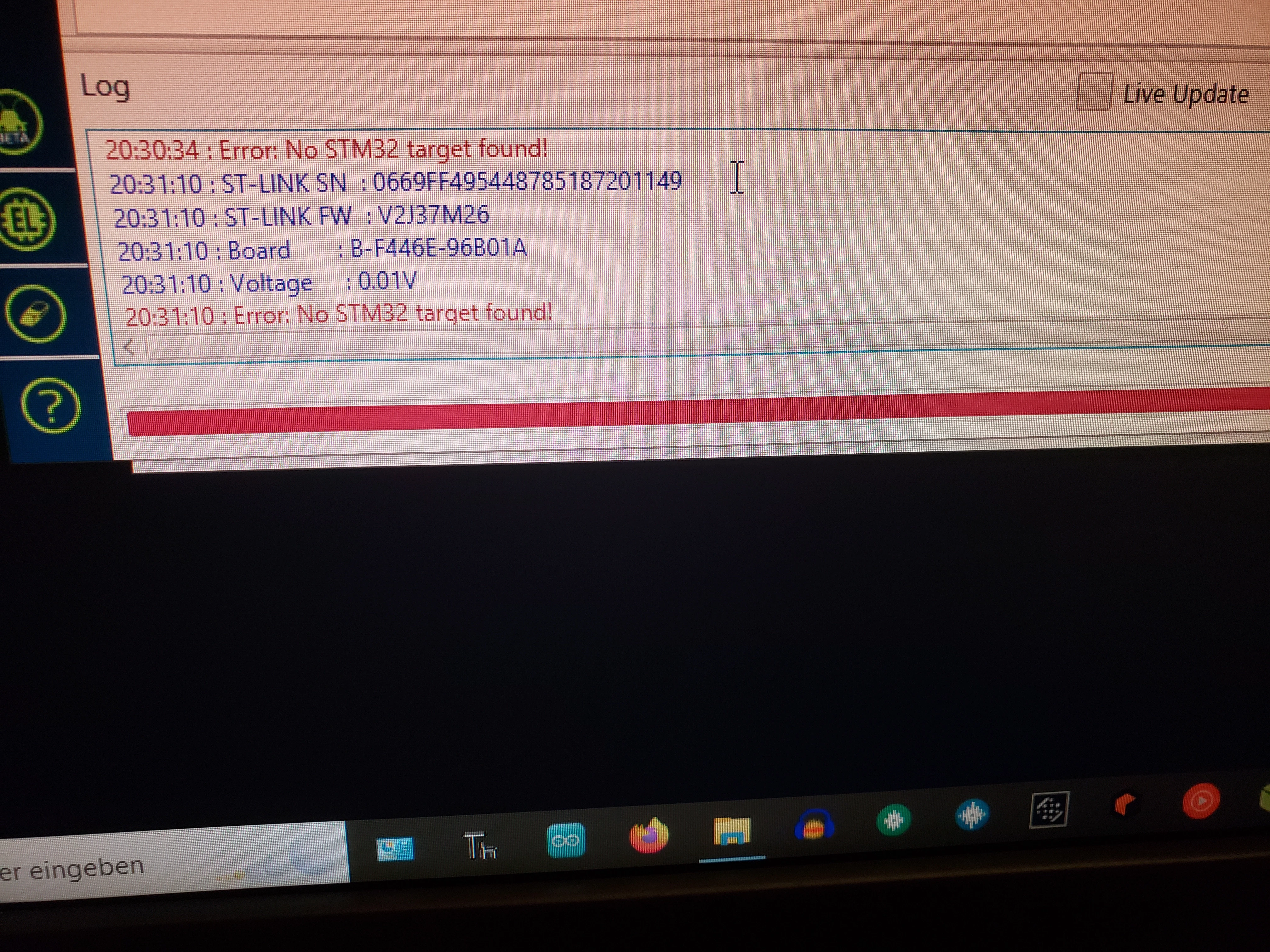

    0693W00000WKjKEQA1.jpgThis is the message I get, when I connect the board to the PC.
    It says: 0 Volt​age.
    What is wrong there?

    This is an old board without a lot of resources.
    Absent a schematic you'll have to trace the circuit, and compare with NUCLEO-64 series boards.
    The failure suggests that the ST-LINK/V2 is not seeing a supply, or have connectivity with the STM32 part.
    Suggest you review how the board is supposed to be powered, or what other board it expected to sit on top of.
    Check jumpers or solder bridges, or if VIN can be powered.

    Hello, yea, you were very right. There is for instance the Dragon Board 410c, a SOC development board with Qualcomm processor, that hosts the board. This isn't a standalone board.
    So all the problems came from a missing supply.

    The block diagram suggests the board can be powered via the Arduino header.
    But this doesn't really address what and how you expect to use the board, as I don't imagine there are a lot of examples.
    The mbed page perhaps provided most details of pins, etc, and NUCLEO-F446 example might port with effort.

    My problem is now solved...I put an Arduino on top of the board, plugged 5V USB power in so the board is now correctly powered up. I have a drive now with about 1,6mbyte of flash. STLink now recognizes the board and the flash memory automaticly
    So I'm now okay with my board......................................
