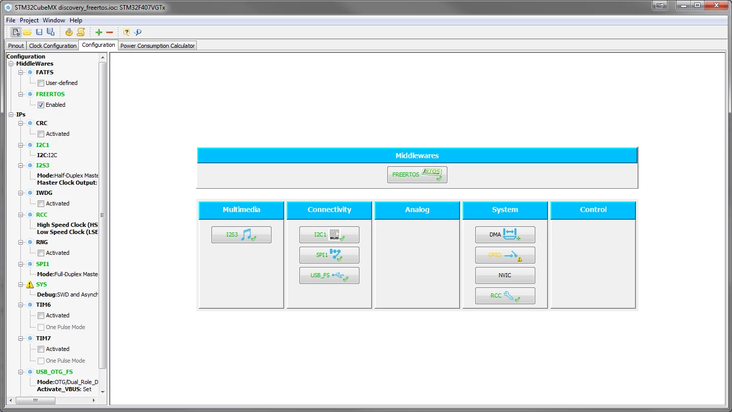

I can't open NVIC windows !!!
Someone knows this problem???

    I noticed this problem, too. It only happens when opening a saved *.ioc file. When creating a new one, it works just fine!
    This should be fixed. It's definitely just a bug in their GUI code.

    Attached is the file I know is not working. This is the problem at least I experience:
    Notice the lack of any formatting of the NVIC button? This should be formatted like the I2C or at least the DMA button. However, it's not. Clicking on it results in absolutely nothing happening, as well. You can no longer gain access to the NVIC settings.

    Bug is confirmed. Thank you for reporting this issue. We'll try to fix it for the next official release.
