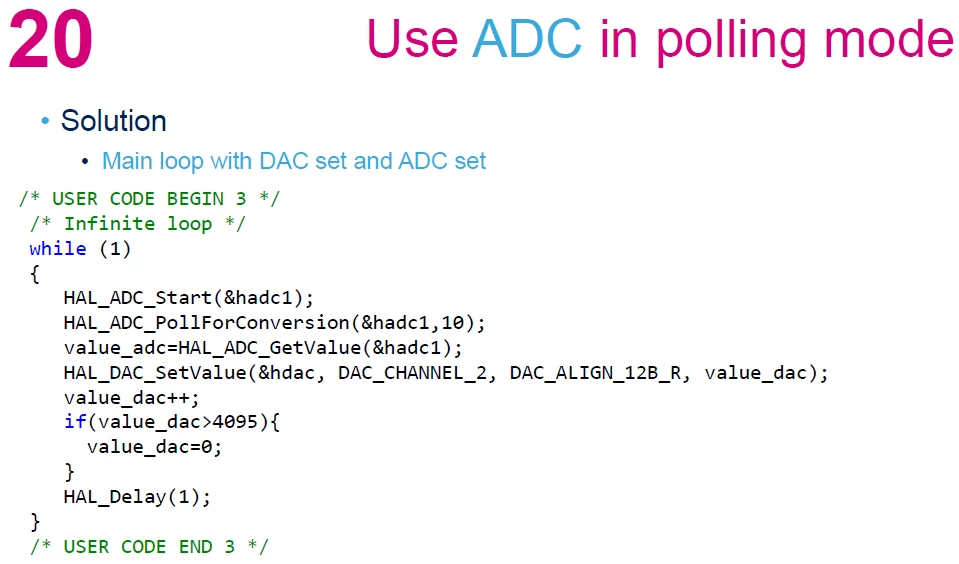

    When I use HAL for ADC in polling mode I follow this approach to get reliable ADC output:

    Posted on March 19, 2018 at 16:35
    Here you can read how to use HAL driver for polling operation. This explain my example provided earlier i.e. HAL_ADC_PollForConversion
    Details in stm32f4xx_hal_adc.c
         *** Polling mode IO operation ***
           Start the ADC peripheral using HAL_ADC_Start()
           Wait for end of conversion using HAL_ADC_PollForConversion(), at this stage
               user can specify the value of timeout according to his end application
           To read the ADC converted values, use the HAL_ADC_GetValue() function.
           Stop the ADC peripheral using HAL_ADC_Stop()
