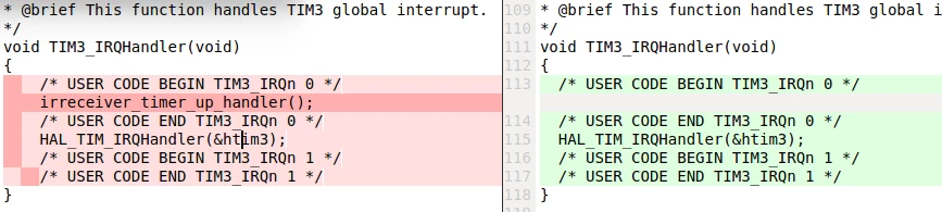

Hello!
After regenerating the project created from previous version of the CubeMX, using new version (4.1), some user defined code has been lost in stm32f1xx_it.c file (image with diff is attached)

    Hi Nikolay Bobovnikov,
    Thank you for your feedback. The issue has been reported internally.

    Dear user,
    Can you please provide the following additional information:
    Which MCU you  had selected.
    With which MX version  the project was initially done (4.12, 4.13, earlier)
    Which option did you  choose when loading your project in 4.13.1: migrate or continue?
    Can you also attached the .ioc configuration file of your project.

    I'm sorry, now I'm not sure about exact version of CubeMX, it was probably 4.11 (definetely not earlierd). I use this MCU: STM32F103C8T6. I chose ''migration'' after installing new version of CubeMX. Project file is attached.

    Dear user,
    Sorry for the inconvenience.
    The generated file stm32xxx_it.c has been enhanced and may have broken compatibility with previous version. That's why it is recommended to back up your project prior to a migration.
    On top, it looks like a bug has been fixed in latest version: On your selection you can no longer accommodate both I2C1 in I2C mode and Timer3 with TI1FP1 trigger source.
