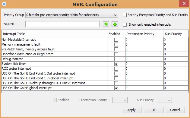

    Posted on June 25, 2014 at 18:51 You should have something like this at start of main():
    HAL_Init();
    SystemClock_Config();
    /* System interrupt init*/
    /* Sets the priority grouping field */
    HAL_NVIC_SetPriorityGrouping(NVIC_PRIORITYGROUP_0);
    HAL_NVIC_SetPriority(SysTick_IRQn, 0, 0);
    MX_GPIO_Init();
    MX_SDIO_SD_Init();
    MX_USB_HOST_Init();
    SystemClock_Config(); will configure you clock and then HAL_NVIC functions setup your interrupt for SysTick_IRQn. Then when the systick interrupt fires your interrupt handler (SysTick_Handler()) should be called, which increases the uwTick variable ( fires every 1ms ). If using MXCube ensure System tick timer interrupt is enabled. 0690X00000605P1QAI.png Does any of this look familiar to your source.
