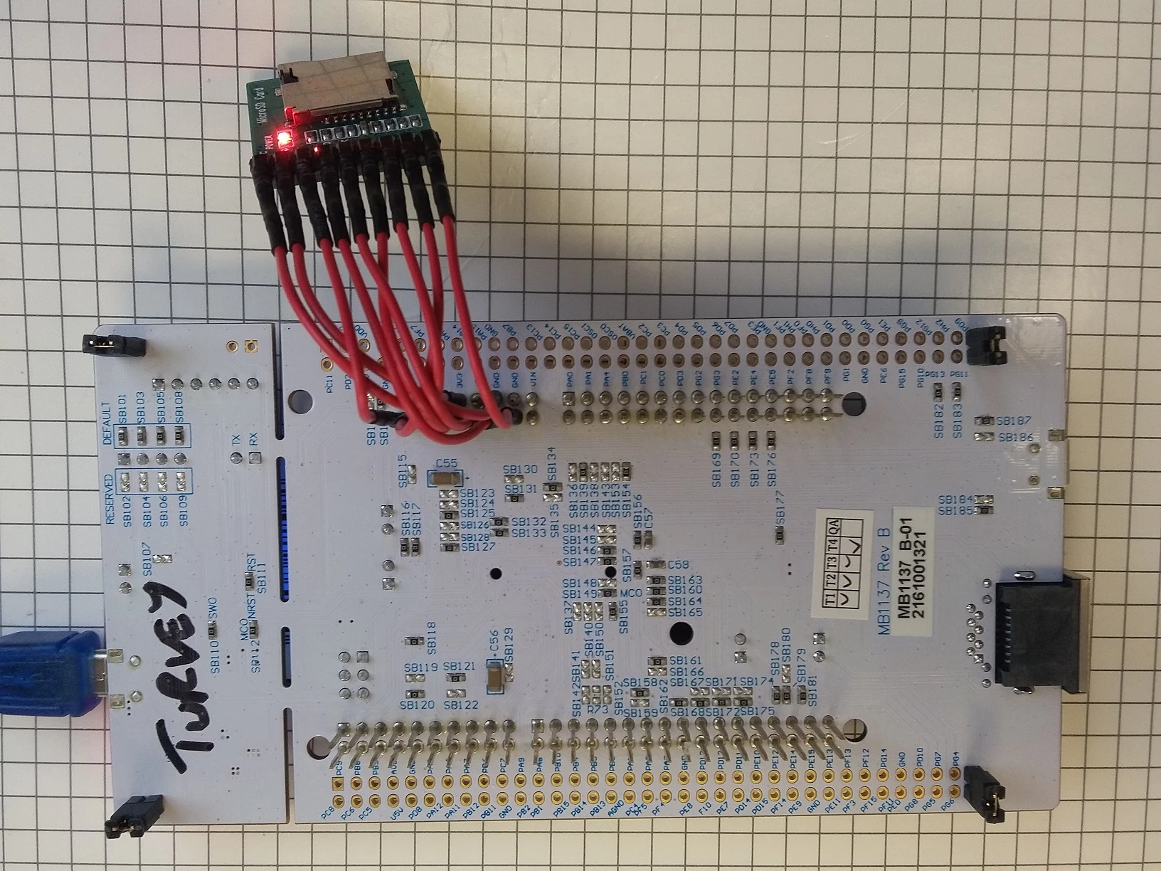

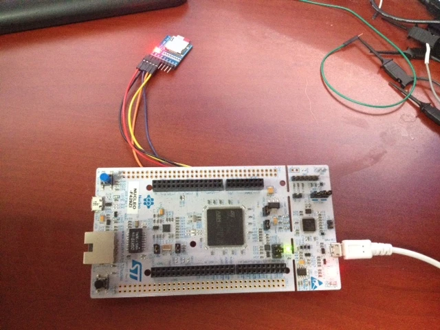

    John Craven
    Senior
    February 15, 2018
    Posted on February 15, 2018 at 23:02
    LOL! i did almost the exact same thing last night.
    Got my FatFS/SDIO working disco-411, and decide to move to the NUC-767 board before adding FreeRTOS in the fray.
    Couldn't get it working for about 2hrs! and sdio was clocking was off what i expected, so i added MCO and figured the whole clk setup was wrong from CubeMX.
    Then i found the 16MHz HSE input freq in cube!
    But, what's worse is this my second time! Forget i reported it, until you posted! LOL
    FYI, Waveshare SD breakout is working fine on 1bit (haven't bothered with 4bit yet)
    http://www.waveshare.com/Micro-SD-Storage-Board.htm
