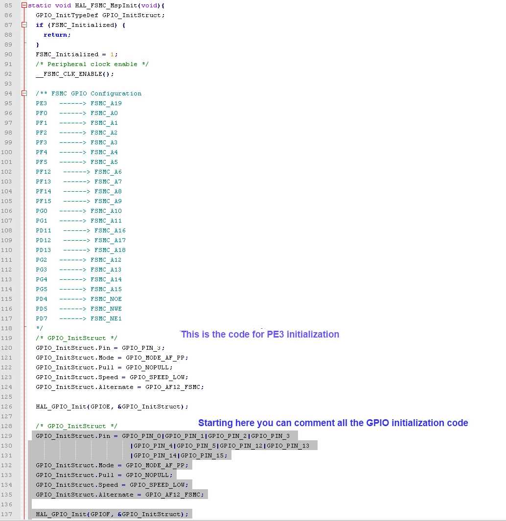

    Use STM32CubeMX and configure the FSMC for 20 bit address (pinout tab) in order to reserve the PE3 pin:

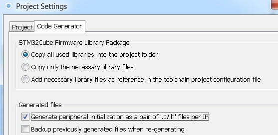

    Configure the Project options from the Project menu to generate peripheral initialization code as peripheral dedicated .c/.h files :
    In the inc/src folders you will find the fsmc initialization code.
    Modify the function HAL_FSMC_MspInit in the fsmc.c file to configure only the GPIO PE3 (i.e. comment all other GPIO initialization code) as shown in example below [Warning: this modification will be overwritten if regenerating the code with STM32CubeMX. So you should copy the code to a dedicated project folder]:
