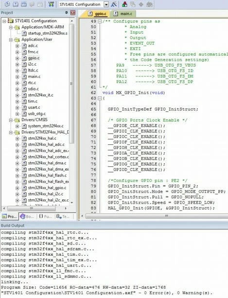

The STM32Cube
project file
attached
does not generate
the file
gpio.c
Can someone help me

    This STM32Cube project is setting to generate code for MDK-ARM toolchain and to generate peripheral initialization as a pair of .C/.H files per IP.
    When I open the code in MDK-ARM in the project window (on the left) this file is required bat not present (not generated by STM32Cube).
    Is there any
    solution ?

    Using the brand new CubeMx version (4.2, released two days ago), I took the .ioc file, generated code for Keil 4.73: no issue in Keil, link with no errors, and the gpio.c file clearly present in the project.
    Maybe it is worth trying with Mx 4.2 (I do not have any more 4.1, then can not reproduce initial problem).

    just to add to the list -- I've encountered the same issue. Create a new project, select ''Generate peripheral initialization as a pair of .c/.h files per IP'' in the settings, enable some random GPIO, then click on ''Generate Code''.
    In the first run gpio.c will be generated just fine. Now close STM32CubeMX, and restart it by double-clicking the respective *.ioc file. Click on ''Generate Code'' again. The gpio.c files is now gone.

    hermann.uwe wrote: ...restart it by double-clicking the respective *.ioc file. Click on ''Generate Code'' again. The gpio.c files is now gone.
    Thanks Herman, since your advice i've opened my project from MX (File -> Load... || Recent...) and the gpio.c file has been generated just fine at each time (...for now). So i to any one struggling with the same issue, close your project (perhaps restart CubeMX too) and open your project from the MX not by double clicking the *.ioc icon.
