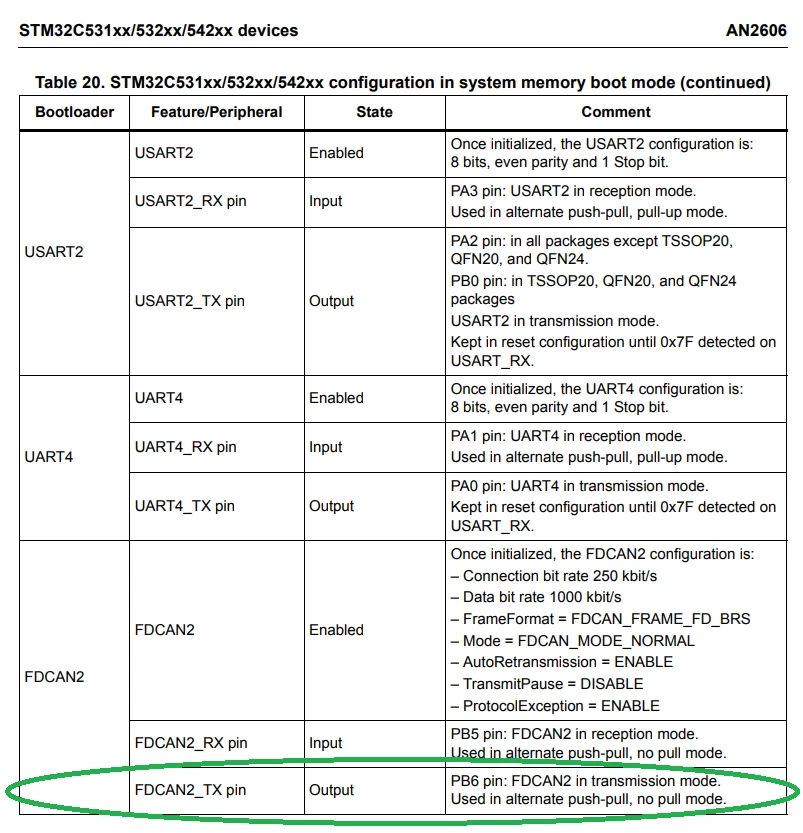

Likely, it’s in the bootloader and PB6 is in use as AN2606 shows. The bootloader will be entered when the flash memory is empty.
Measuring resistance on a pin in use leads to invalid results.

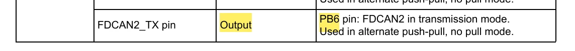

For PA15, PA13 and PB4, I am able to confirm the PU to VDD, as mentioned in the datasheet. Similarly, for PA14, I can measure pull-down resistance to VSS. The values were ~32-37 kOhms. Hence, I will not outrightly say that measuring resistance on a pin in use will lead to invalid results. It gives me an indicator, if not the final result.
Sep 9, 2026 2:20 PM UTC
I do not see any mention about PU or PD for PB6 in bootloader mode. AN2606 still does not explain the issue I am facing.
It shows here that the pin is put into output mode. FDCAN_TX output pin is idle high, hence the “short” to VDD. What’s really happening is the MCU is sinking the injected current from the multimeter. The response from the circuit is not due to resistance.

What is being explained is that in your configuration (are you using a NUCLEO PCB or probably in Bootstrap) then the bootstrap firmware runs at start up and configures PB6 pin as FDCAN2 in transmission mode (and used in alternate push-pull, no pull mode).
The ST32C532 after reset enters pattern 19 (which gives from AN2606):-
  1. Boot0(bit) = 1 and BootSel(bit) = 0
  1. Boot0(bit) = 0 and BootSel(bit) = 0, and user flash empty
  1. BootSel(bit) = 1 and Boot pin = 1
so if your ST32C532 flash is empty it has to, must, enter bootstrap
Now if it enters bootstrap it will configure PA6 as an output pin pulling to VDD.
Don’t try to measure resistance with power on - measure pin voltage instead and it will likely be VDD.

Hi ​@rich.g.williams , I tried a similar approach, to confirm whether the voltage levels hold during the MCU reset state. I pulled the NRST pin low, which inturn made the PB6 logic LOW as well. I need to verify this across other relevant pins as well, but your explanation could very well be the answer I am looking for. Thank you!
