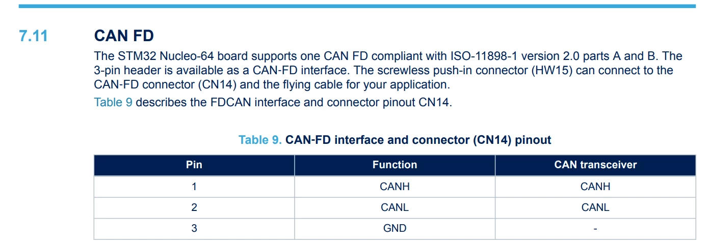

Edit: NUCLEO-C092RC has already a CAN-FD transceiver:
No need to add another CAN transceiver.

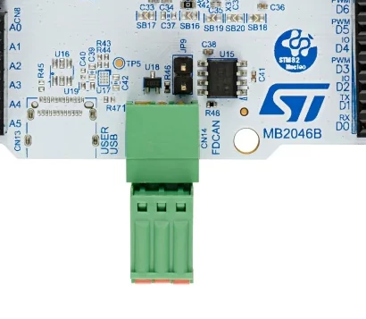

And this is the CAN connector (in green) correspond to CAN_H and CAN_L + GND (I think):
Hope that answers your questions.
