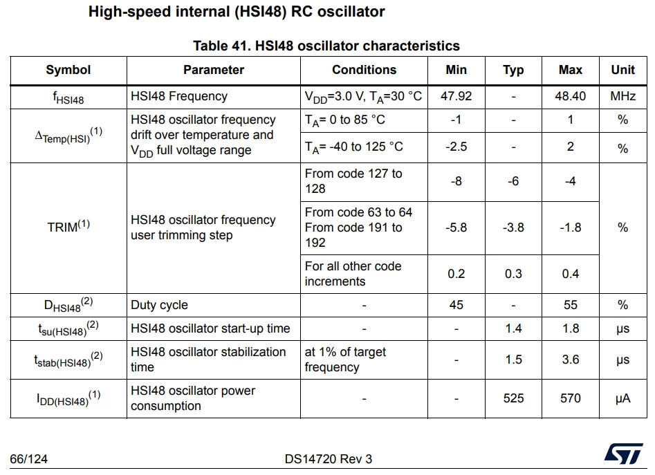

Andrew Neil
Aug 7, 2026 10:26 AM UTC
  • Clock source: Internal HSI (48 MHz)
So what is the accuracy spec on that ?
Have you measured the actual frequency?
PS:
https://www.st.com/resource/en/datasheet/stm32c091cc.pdf#page=66

Aug 10, 2026 5:42 AM UTC
Thank you both for the feedback.
We have checked the HSI48 specification and performed timing measurements on our STM32C091CCT6 hardware.
1. What is the HSI48 accuracy specification?
Our understanding from the STM32C091CCT6 datasheet is that HSI48 is a nominal 48 MHz internal RC oscillator, with its accuracy depending on VDD and temperature.
At VDD = 3.0 V and TA = 30 °C, the datasheet specifies/characterises HSI48 around:
  • Minimum: 47.92 MHz
  • Nominal: 48 MHz
  • Maximum: 48.40 MHz
The datasheet also specifies approximately ±1% variation over the 0 °C to 85 °C range, with wider variation over the extended temperature range.
Therefore, an approximately +0.5% deviation is within the expected HSI48 operating characteristics.

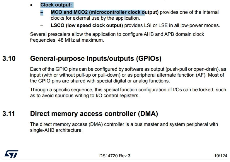

Andrew Neil
Aug 10, 2026 7:35 AM UTC
2. Have you measured the actual frequency?
Yes, we have measured the timing externally using a logic analyser.
So you have not actually measured the HSI frequency.
Route the HSI to an MCO pin, and measure it directly:

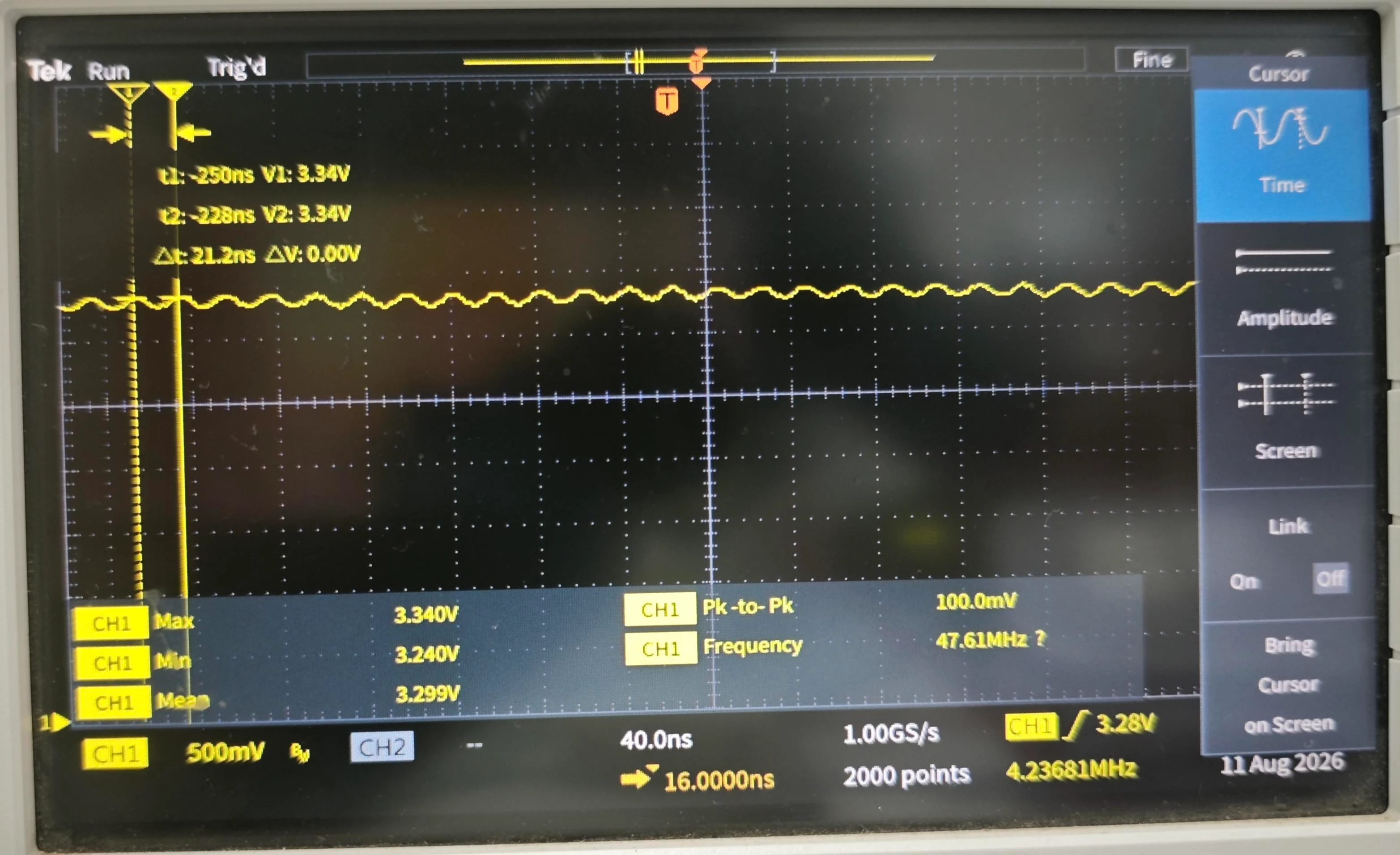

Aug 11, 2026 8:23 AM UTC
We measured the HSI48 directly through the MCO output on PF2.
The oscilloscope shows approximately 47.61 MHz versus the nominal 48 MHz, which is about −0.81% (−8,125 ppm).
Attached is the oscilloscope screenshot for reference.
We are also checking the RCC/TIM14 clock path against our earlier ~995 ms measurement before drawing a conclusion about the timer error.
Gyessine
Aug 11, 2026 9:30 AM UTC
Hello ​@Sandeep.nandwana
Just a quick question
what sampling rate are you using in the logic analyzer?
make sure it’s the maximum of 500MS/s
BR
Gyessine
Aug 11, 2026 10:56 AM UTC
Hi Gyessine,
Thank you for the suggestion. We have checked the timing both with the logic analyzer and directly with the oscilloscope.
With the logic analyzer, the nominal 1000 ms window is measured around 995 ms. We also verified the timing on the oscilloscope.
With the software compensation set to 1,005,000 µs, the measured window is now approximately 1 second accurately.
We will also verify the logic-analyzer measurement at the recommended 500 MS/s sampling rate.
