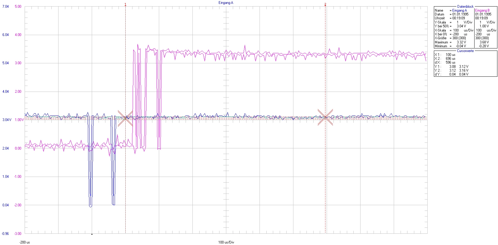

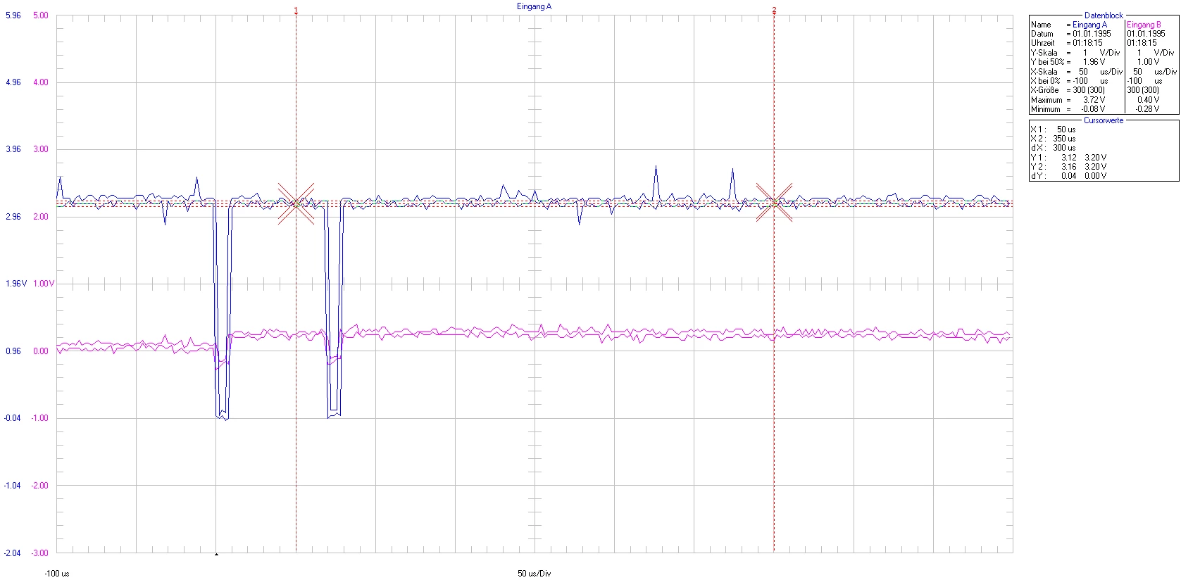

When I respect problem 1, I can always make the processor not start up the application. I remove full power. I set Boot0 Pin to high level and reset the uP with a low going impulse on nRST Pin.
Sometimes I can program the uP now, but in 90% of the cases the processor is not answering on his TX Pin (PA9)
This is the case serial download is working: blue is the character from Computer. Red is the answer from built in bootloader.
This is the case with a download fail. TX Pin (red) is always low, even with Character on RX Pin. So I think internal bootloader is not running or it is running on a wrong interface.
I'll also tried the newest STM32Programmer V2.20.0. Result same failure rate.
