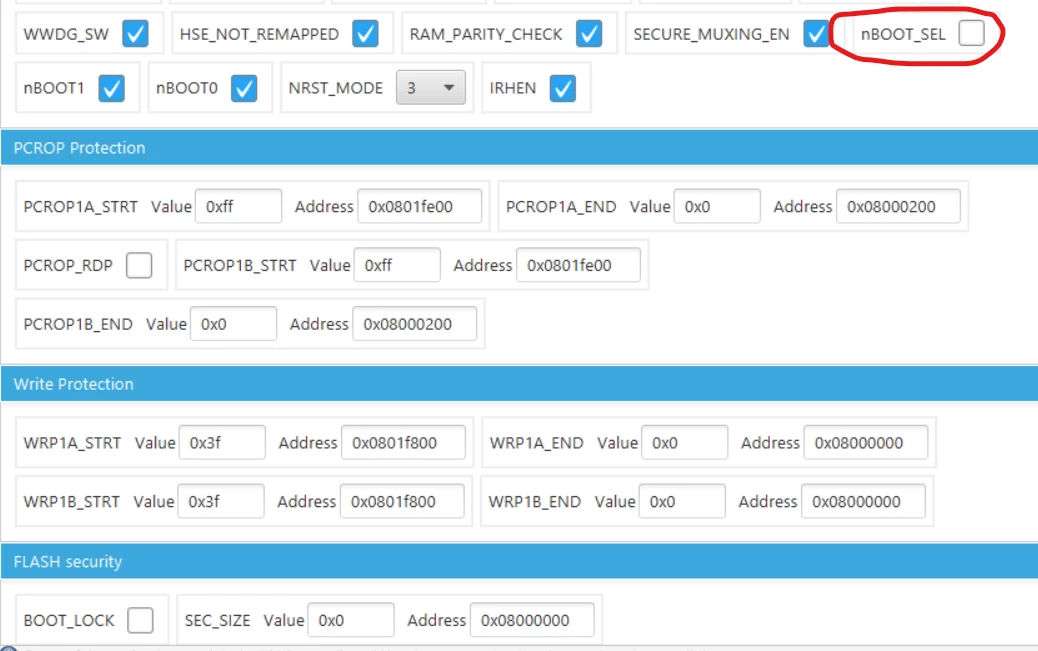

how do I start the USB DFU Bootloader with a STM32C071 Nucleo? I tried it while putting Boot0 to high and pressing reset or do a power cycle but the STM32 DFU does not show up in the device manager. I connected USB to the NUCLEO extra USB port of the C071. I tried with another board (F2 MCU) where it worked well to prove that the drivers are installed.

Now it works: The BOOT_LOCK option bit was set to 1. With BOOT_LOCK set to 0 and nBOOT0_SEL set to 0 it works well.

These are the ways to enter the bootloader on startup:
Empty flash check requires a power reset.
You will need to have both USB cables plugged in to ensure the chip isn't held in reset by the st-link and the USB DFU cable needs to be a data cable, not a power-only cable.

> In my understanding I just have to press the Boot0 button and do a power cycle? Or what I'm mising?
Well, let's look at the default values for the option bytes, which is found in the reference manual.
Okay, so we know NBOOT0_SEL = NBOOT0 = NBOOT1 = 1 (ignore the small typo) and BOOT_LOCK = 0.
Let's now look at AN2606 table to see where that puts us.
Since NBOOT0_SEL = 1, the state of the BOOT0 pin doesn't matter. Here are the ways to get into the bootloader:
The only way possible with default option bytes is if the main flash is empty. So do that using STM32CubeProgrammer, or change the option bytes so BOOT0 high can enter the bootloader.

Hi, I did change the option bytes as you say but still the USB DFU bootloader does not show up in the device manager. I also erased the flash just to make sure. What am I missing?
Sep 25, 2026 9:20 AM UTC
Small summary of that TDK described in detail: on a blank nucleo BOOT_LOCK is unchecked, the problem is in nBOOT_SEL.
Once unchecked that, the Boot0 switch can select the bootloader during a reset
