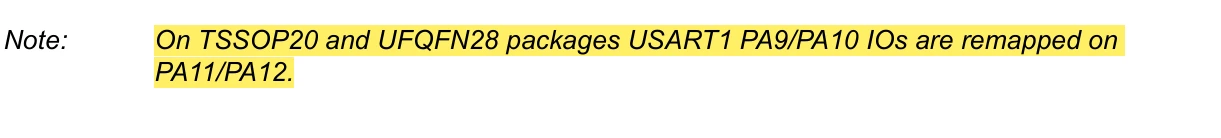

Indeed, UART1 is not available on STM32C071/ UFQFPN28 package.
For C031 device a remapping was applied in the bootloader, see this note in the AN2606:
That's why the USART is available on C031 for the UFQFPN28 package.
For C071, USB/DFU has been added versus C031 and you should use USB instead of USART1 for C071.
Hope that answers your question.
