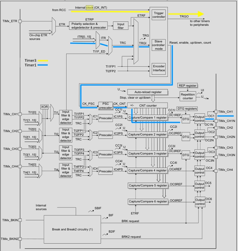

STM32C031C6 Timer confusion
The code below links Timer1 in master mode to Timer3 in slave mode producing a 4 second toggle on PB8 and it works correctly.
My question is I'm not able to follow the flow of the signal in the Timer chart below the code.
If someone would show me the signal flow I would appreciate it. I have shown how I think the signal flows. Is this correct?

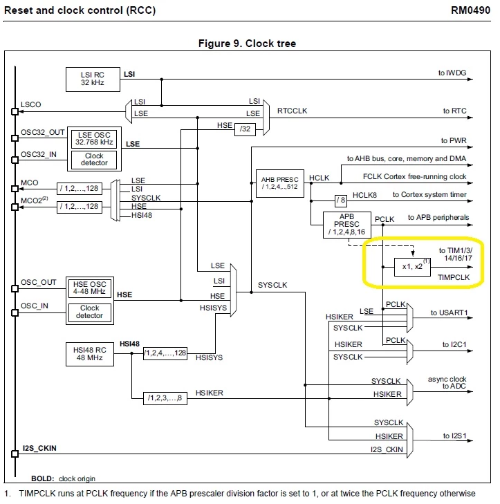

Your Yellow line makes no sense. CK_INT comes from the RCC / APB clock sources, for the peripherals.
The other timer signal would come in via ITR, secondary clocking via ETR

Thanks, the more I looked at it the less sense it made but I couldn't find an alternative. Never thought to go to clock tree diagram.
That clears up a lot.
