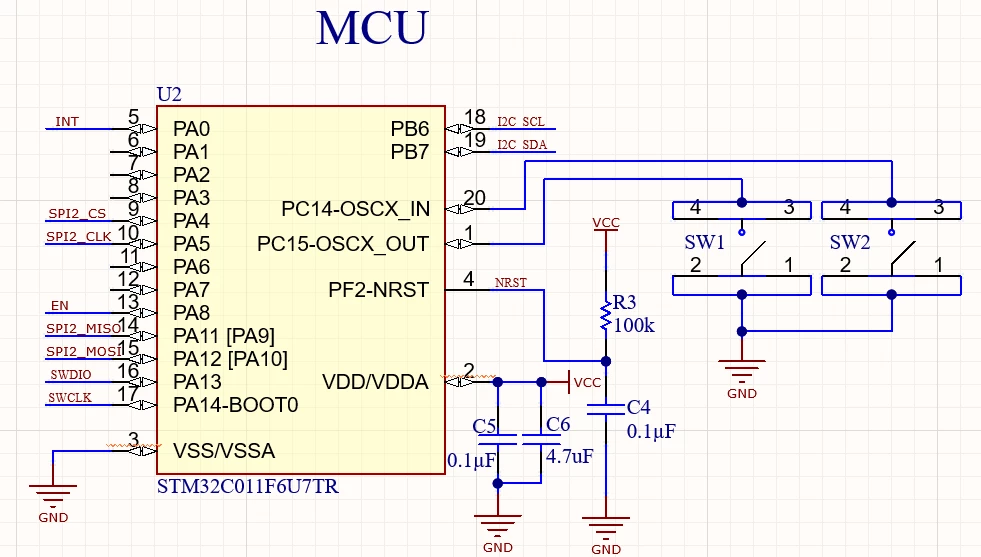

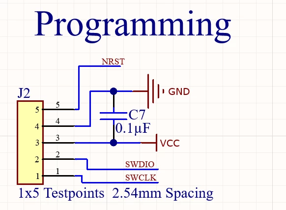

Hi Guys,
I will use STM32C011F6U7 did my devices development, but I can not certain that the schematic is correct or not, is right for NRST part? same time I want to know what tools should I used to download FW to units, 5 pins J-LINK or others 4 pins tool? any comments?

Hello @gavin3
I suggest you refer to the AN5673 to have tips on design using the STM32C0.
Best Regards.
STTwo-32
Simon.T
April 2, 2024
Hello @gavin3 ,
As @STTwo-32  said you can follow the AN5673 hardware getting started, or you can also take the NUCLEO-C031C6 schematic as reference.
Also an internal pull up is already present inside the NRST pin, so I recommend you to remove the external pull up.
