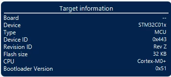

This is the result when STM32CubeProgrammer reads the chip:
This is when STM32CubeIDE reads the chip

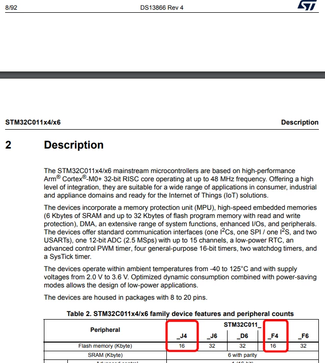

why do we see different available sizes with different tools?

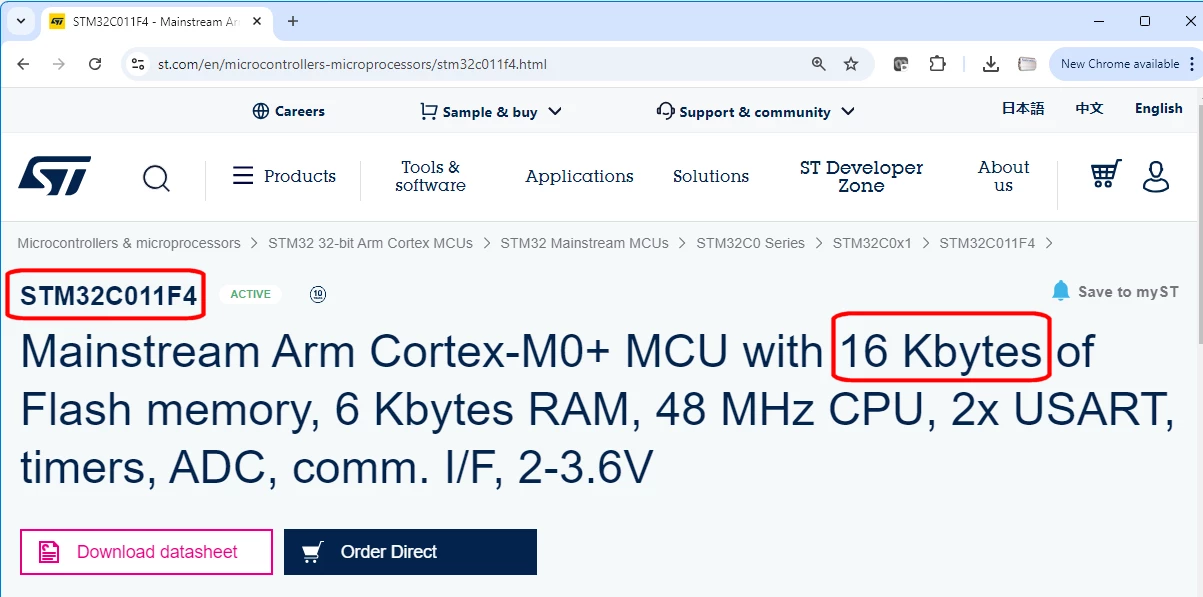

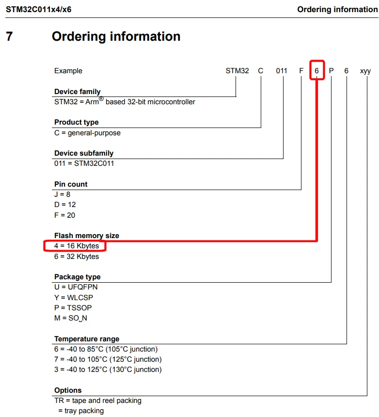

STM32C011F4 only has 16K of Flash:
https://www.st.com/resource/en/datasheet/stm32c011f4.pdf

Although the F4 and F6 are the same die, the F4 has only 16 kByte of flash - officially. The extra 16 kByte might not be tested, might even be defective or slightly out of specs. Some tools might allow use of the extra flash, others might strictly stick to the advertized flash size ...
