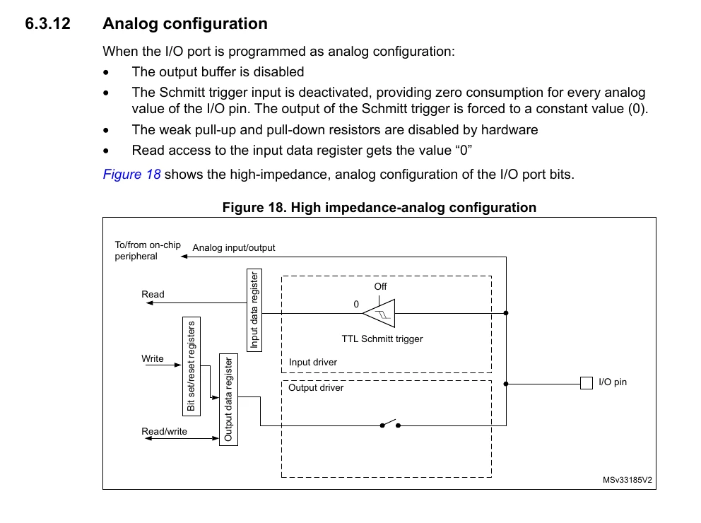

I read on the errata that there's a bug in the revision A (2.2.2) that says that on PA11 the Schmitt trigger remains effective in analog input mode. The bug should be resolved on the revision Z of the silicon (the one I have). The behavior I'm observing seems to be exactly the same as the Schmitt trigger remains active but in all the pins I tested (PA3, PA4, PA5, PA6, PA7, PA10 and PA12).
In addition, when I configure ADC1_IN7 on PA7, ball E2, and set to analog input PA12 I can read the input signal on GPIO's IDR as PA12 was a digital input. From the datasheet I expected to read 0 because the input Schmitt trigger should be disabled and logic value forced to 0.

>All the other ports are set as analog inputs with no pulls.
So what happens, if you set this pin for ADC_in also to "analog" (=disable digital functions) ?
Should need no current then; and only switch to ADC_in , if just needed to measure.

So, the things I can't understand are why:
 - Why I see 165 uA of extra current if the digital  frontend (Schmitt trigger) is disabled?
 - Why i see the input data register of GPIOA reflecting on pin 12 the state of the input voltage if the digital  frontend is disabled? The reference manual (6.3.12, figure 18) says that the input should be read as 0
Also the bits of GPIOA IDR related to other pins don't look correct if I'm not missing anything: for example PA0 is set as analog (watching the same MODER register value as before) but into the IDR it is set to 1.
Am I missing something or the pins that should be set as unconnected are somehow left with the digital input stage enabled?
