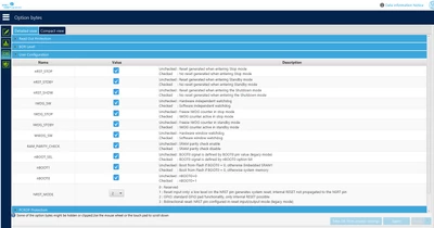

Explorer II
Mar 11, 2025 12:14 PM UTC
There is a safer way to set the NRST pin as GPIO.
  1. Open STM32CubeProgrammer and connect to your target device.
  2. Look for the Option Bytes menu (third tab on the left).
  3. Unpack User Configuration menu.
  4. Find NRST_MODE and set it to 2 (GPIO: standard GPIO pad functionality, only internal reset possible).
  5. Click Apply and power cycle (or disconnect from target)
