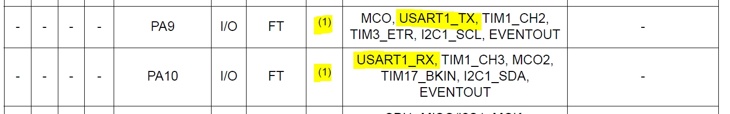

However these are not the usual pins that I typically use for UART on STM32C011. My firmware also uses UART1 to communicate with an external microcontroller and in that case the pins that the datasheet states I can use are:
USART1_TX: PA0,PC14,PB6;
USART1_RX: PA8, PC14,PB6, PB7;
Why are the pins used in your bootloader not the same as the ones that should in teory be used for USART1? How can I use the same pins for bootloader and user firmware?

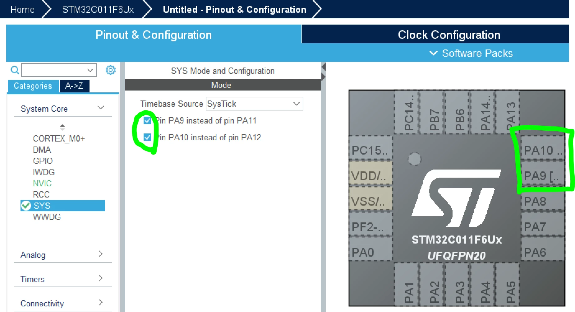

Remapping PA9/PA10 on PA11/PA12 does exactly that--it physically (via a switch) connects the PA9/PA10 pins to the external PA11/PA12 pin positions.
Load up CubeMX and maybe that will help with understanding.

You can use PA9/PA10 which are remapped on PA11/PA12 here to communicate with the bootloader. I don't see what the problem is.
PA9/PA10 are listed as USART1 pins in the datasheet.

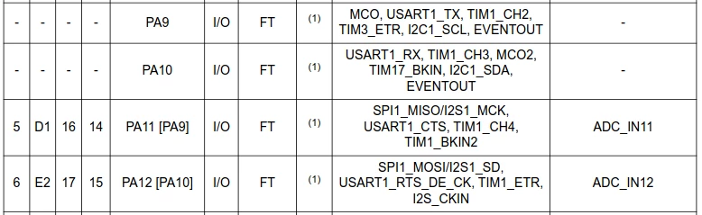

The problem is that with my package(UFQFPN20), PA9/10 are not present. As you said they are remapped on pins PA11/PA12, but on the datasheet PA11 and PA12 don't have USART1_TX and USART1_RX as you can see in the following table.
Even STM CubeMX doesn't allow me use PA11/PA12 for USART1.
So that's the source of my doubt. But if you confirm that I can indeed use PA11/PA12 as USART1 then it's perfect.
