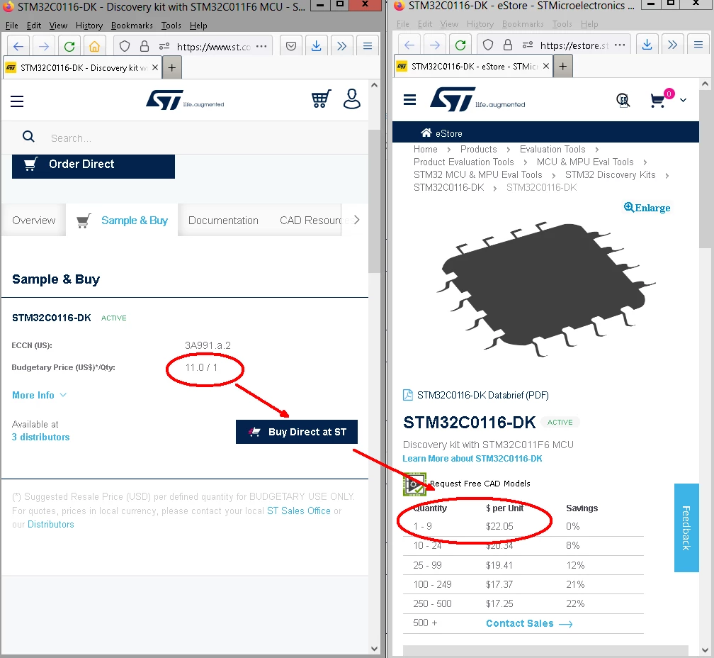

I had a look at the DISCOs. To be honest, they are lame, sorry. For example. why using proprietary LCD on the "little" one, why not a standard HD44780-compatible, with as standard pinout as possible, to maximize the chance of it working with whatever spare we have in our drawer? There's also no noteworthy perk on the "bigger" one.
The point of the DISCOs would be to make us to to do impulse purchase, play with them a little, and then put them on the shelf with the feeling of "oh now I know what this line is about". Without any such perk (or with the perk requiring me to purchase extra parts and not-that-usual headers/cables/etc), I just skip. And so will other users.
I know you hand them out at seminars and trade shows, but that's not the same thing, by far not. Buying one is an entirely different thrill and makes an entirely different impact. I understand that this all is hard to convey to the marketing folks, but I thought Discos are made by engineers. And here we arrive at this:
which makes me even less willing to buy one, leaving a bad aftertaste instead (especially during an introductory period). (We'd need to discuss your whole "store" too, but that's for another day.)
Discos used to be a vital part of the STM32 success, but since the overcomplicated Discos of cca the 'F7, you've sort of lost it.

The dedicated LCD connector for NHD-C0216CZ-FSW-FBW-3V3 is a solution for LCD demo.
Personally, you can use the CN1/CN5 connectors to extend your application for SPI LCD freely.
Eric
waclawek.jan
March 30, 2023
Hi Eric,
Of course I can. But that means to make an adapter/cable, and that's an annoyance. Disco boards are mean to be fun, not annoyance. NHD-C0216CZ-FSW-FBW-3V3 is very expensive, more expensive than the Disco board itself, so it's very unlikely anybody is willing to buy one just for that fun. There's an abundance of cheap alphanumeric LCD modules with a defacto-standard 14+2-pin layout, and many developers have some laying around. This could be also a great opportunity to showcase how such modules designed primarily for 5V operation could be used with the STM32.
I see this as a missed opportunity.
Jan

Hello All,
The price of the development boards at our distributors has been adjusted to be in line with the "recommended resale price". Sorry for the inconvenience.
Simon
