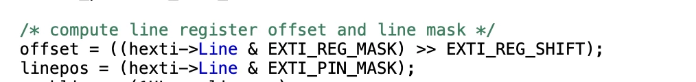

I'm new to STM32 and I'm exploring it a little bit. I think I've found an issue in the HAL
in configuration Line is referred to the external interrupt line to be connected.
it is configured in the BSP with  (void)HAL_EXTI_GetHandle(&hpb_exti[Button], BUTTON_EXTI_LINE[Button]);
where static const uint32_t BUTTON_EXTI_LINE[BUTTONn] = {BUTTON_USER_EXTI_LINE}; and BUTTON_USER_EXTI_LINE is 0x2000;
the problem is in the usage of Line (in all the  stm32c0xx_hal_exti.c file!)
linepos is almost always 0 since EXTI_PIN_MASK is 1 and this is wrong. Removing the & all seems to work properly.
Since it one of the first test that I'm doing with the ST IDE and HAL might be I'm doing something wrong :D

Hello @STDoom ,
First of all, welcome in the ST community.
Is it possible to send you code ? Because I tried to have an EXTI interrupt with the BUTTON_USER and I'm facing no issue and it is working fine.

Hello @STDoom ,
I confirmed your issue and I have submitted an internal ticket addressing your request to the dev team.
Internal ticket number: 179773 (This is an internal tracking number and is not accessible or usable by customers).
Your workaround is working. Thanks for your contribution.

Hello @STDoom ,
To fix the issue in the bsp header file "stm32c0xx_nucleo.h" line 191 you need to replace this code:
#define BUTTON_USER_EXTI_LINE GPIO_PIN_13
by this code:
#define BUTTON_USER_EXTI_LINE EXTI_LINE_13
This will be implemented for the Cube FW revision.
