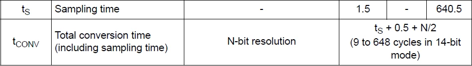

As per reference manual (Page-874, RM0433, Section: 25.3.13 Channel-wise programmable sampling time (SMPR1, SMPR2))
Tconv = Sampling Time + 7.5 ADC Clock Cycles
BUT, when i check in the STM32H753xI-datasheet (Page-160)
Tconv =  Sampling time + 0.5 + N/2 where N= N-bit resolution.
Is it typo issue because you will get 7.5 only when N=14 ?

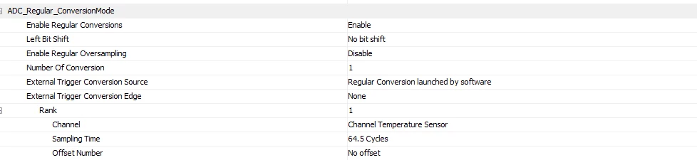

1) I have checked it in my CubeMX V4.24.0. I can change the sampling time for temperature channel in the ADC3 config:

Mohamed Mansouri
Visitor II
Jul 11, 2018 11:01 AM UTC
Posted on July 11, 2018 at 13:01
Hi
manishsharma3134
As
Wedell.Tobias
  said, you can select the sampling time in CubeMX depending on your requirement.
Also, about  Tconv:
  • in the Ref Man, Tconv is calculated for 14-bit mode resolution.
  • the Datasheet shows the general rule to calculate Tconv depending on the sampling time and the ADC resolution. Indeed, it shows just the number of cycles (ts + 0.5 + N/2 ). therefore, The deducted number should be multiplied by ADC clock cycles to get Tconv:
    • For example, for ts= 1.5 and for 14-bit mode resolution: (ts
       + 0.5 + N/2 )=1.5+0.5+14/2=9 cycles. And In case of ADC clock cycles equal to 24 MHz, Tconv=9/24=0.375 ?s.
Hoping it helps you, Please do not hesitate to contact me for further details.
