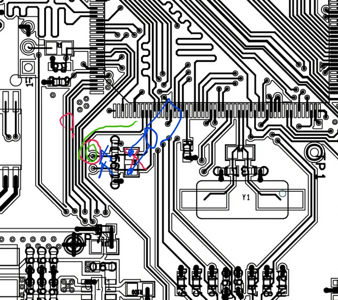

Hi Everyone,
I am working on RTC with stm32f746g controller. I tried number of option but i am not getting accurate time.
After some time rtc is getting lag of 4 to 5 seconds and it keep on lagging in time.
I am using 32.768khz exteranl crystal with 24pf capacitors.
I tried by changing this capacitors value 22pf,15pf,10pf also but still my problem is not solved.
I did internal rtc calibration also to minimize this error by changing prescaler values but still i am getting time lag.
Can anyone suggest me any other option which will work out and i will get accurate time?
    After what time? When talking about error in measuring real-time, it's customary to give it in ppm = parts per million = (deviation / total elapsed time) * 1,000,000.
    With the LSE/32.768kHz crystal, up to 100ppm is relatively normal, 10ppm is what can be achieved with moderate effort. 100ppm converts into cca 8 seconds per day.

    Read out and post the content of RCC_BDCR, RTC_PRER and RTC_CALR.

    I checked your watch crystal pullability which is good from Abracon datasheet. The PPMs you have are not normal. ..
    I recommend you the following :
    1) Read our exaustive App note
    https://www.google.tn/url?sa=t&source=web&rct=j&url=http://www.st.com/resource/en/application_note/cd002216pdf&ved=0ahUKEwiFzuzw68_VAhVHQJoKHTaACFoQFggcMAE&usg=AFQjCNEN6KP-3BkBtlNX4u_tpDbFhRls6A
    Be patient to the end. I know it is long.
    2) First please in Firmware select our highest drive of LSE bits to 0x11 to be ableto match thus crystal :ESR max is 30KOhm which is helping a lot.
    3) CL1 =CL2 should be in range of 20pF . I Assumed your Cs =2.5pf bu I need your schematics and PCB layout to do a sanity check. You need to create a local ground loop to isolate PC14 and PC15 from other high speed signals crossing. .. I recommend then to do a tuning using an universal counter and output LSE clock at MCO pin PA8. Please do not use PC13 pin at thus step and avoid toggling it... it may disturb PC14 osc in.
    4) tune CL1 and CL2 until you will get a proper PA8 output at 768KHz +/- your PPMs. You can monitor your duty cycle also it should be in range if 40 to 60 %.
    5) Do not activate other peripherals. During (3). You can even put the CPU in sleep mode.
    6) I m sure you will untersrand and debug what is happening in your case.
    Cheers

    Please check attached schematic and layout of the board. Let me know hardware point of view it is correct or not.
    Also tell me how much Cs i should consider while calculating CL1 & CL2 values.Now i am using 24pf Capacitors.
    Nikhil

    Dear
    Gopale.Nikhil
    I would recommend you to monitor PA8 using an universal counter and see the LSE accuracy at 32,768KHz to find the right CL1 and CL1, the right value will have the closest frequency to Nominal.
    I strongly recommend to remove the 1MOhm parallel resistance and use its footprint to rework the watch crystal ( swapping its ends) as shown. It will increase the immunity of the osc-in versus the PC13 ( SD card ?).
    It may happen also due to PC13 and other high speed signals crossing some pulses are skipped and so the the huge drift. .. you can see iton PA8 also with an oscilloscope.
    I would recommend to start with CL1/ CL2 at 15 pF.
