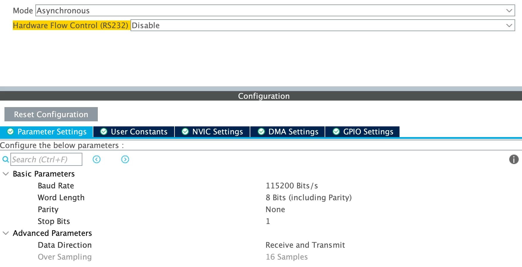

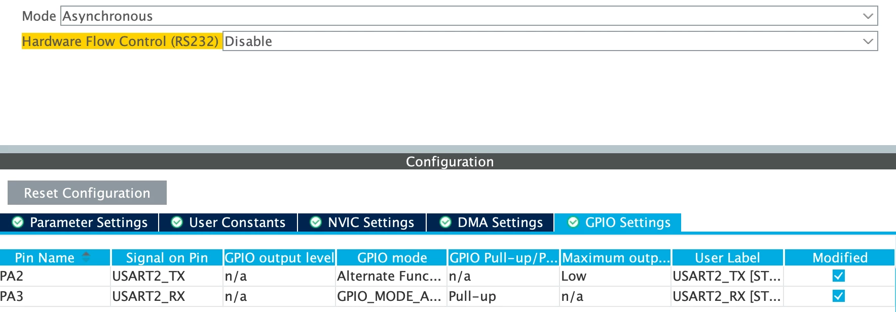

In the attached images you can see the configuration.
If someone knows what is wrong let me know, because I'm stuck and I don't have that much experience to debug this problem. If you need more info just let me know.

If you want one character, try doing that, and not 10
Perhaps try a loop-back confirm if its a reception issue (ie RS232 DB9 Pin 2 to Pin 3), or a signal issue. Send and receive back.
Show wiring
Put a scope on the signal, check USART2->SR for any sticky reception errors
Been an age but doesn't the STM32F1 USART_RX pin need to be in INPUT Mode, not PP AF ?

I got it working by changing the USART2_RX pin to INPUT Mode. First I could not change the mode. I had to disable FSMC somehow the pins are connected to each other. Maybe you know why this is?
