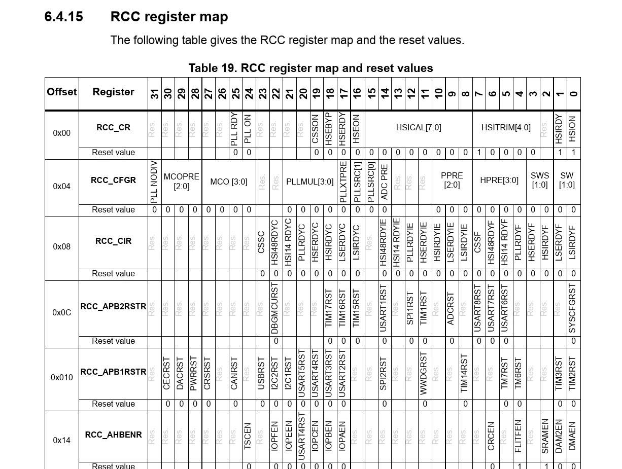

I'm newbie but I need to check if the second code block includes the first code block.
I'm dealing with stm32F072xx.
If required I can share more part of code.

my questions is:
Does the second code block includes the first code block?
GauchoAuthor
Apr 27, 2024 9:59 AM UTC
The two code sections are written in a different way but I suppose they are 2 different methods to set clock and pll. But I’m not sure if the second includes the first one
GauchoAuthor
Apr 27, 2024 11:46 AM UTC
I'm tring to understand it by myself.
The following part seems to use pll with 8mhz input,  divided by2 and multiplied by 12, to obtain 48Mhz, but this part seems to be equivalent to the use of HSI48 to obtain the same result of a 48Mhz:
RCC->CR |= RCC_CR_HSION;
while(!(RCC->CR & RCC_CR_HSIRDY)){};
RCC->CFGR &= ~(RCC_CFGR_PLLMUL | RCC_CFGR_PLLSRC);
RCC->CFGR |= (RCC_CFGR_PLLSRC_HSI_DIV2 | PLL_MULT_X12);
/* Turn on the PLL and wait for the hardware to set the ready flag */
RCC->CR |= RCC_CR_PLLON;
while(!(RCC->CR & RCC_CR_PLLRDY)){};
For the second part it is still not clear to me how to convert it to HAL:
/* Now set the clock source of the system clock */
RCC->CFGR &= ~(RCC_CFGR_SW);
RCC->CFGR |= RCC_CFGR_SW_PLL;
while(!(RCC->CFGR & RCC_CFGR_SWS_PLL)){};

To see, what its doing, look at rm , RCC registers:
If using HSI at 48M , is same clock, but precision on crystal->HSE->PLL is better . If not needed, can use HSI also.
