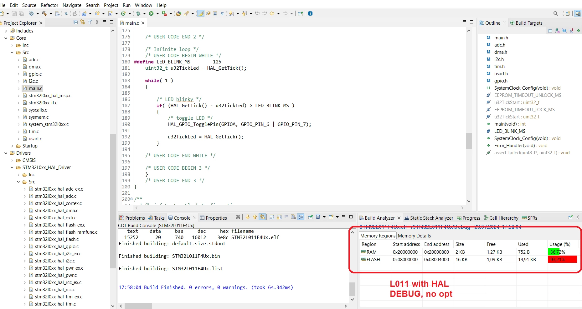

... leads to "funny" results:
STM32L011 with 16 kB of flash, HAL inits and LED toggle in main, DEBUG, no optimization:
93% of flash used
I had not expected it to be that bad! :grinning_face_with_sweat:
Okay, I will probably not use too much HAL, will use Release version with optimization,
but I better select an L01 in the next bigger QFN package (4x4) to get 32 kB of flash.

Your screenshot show many peripherals , then maybe your LED toggle count bitcoins too ...

Show the results with "Optimise for Debug" (-Og).
You should also take a look at the map file - is it actually HAL that's using all that space ... ?

The Memory Details tab gives you more insights.

Yes, luckily I know all that - it was just a bad surprise and might deter some complete STM32 beginners.
So, this wasn't actually a call for help, just ... being "amazed" at how things are. Until now I only worked with "bigger" STM32 (G4, F7, H7), and occasionally using HAL or at project start wasn't a problem.

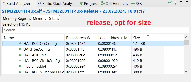

The list file showed mostly the "bloated" HAL inits - I actually forgot about the "Memory Details", thanks @KnarfB .
With release / optimization to size, it drops to 56%.
Record holder is HAL_RCC_Config with 1.15 kB, together with HAL_RCC_ClockConfig and HAL_RCCEx_PeriphCLKConfig taking up even more than 10% of the 16 kB.
These are the HAL setup functions I always use - I guess I have to overcome my laziness in that area.
BTW - RAM: the default CubeMx settings for heap and stack also took up ~90% :D
