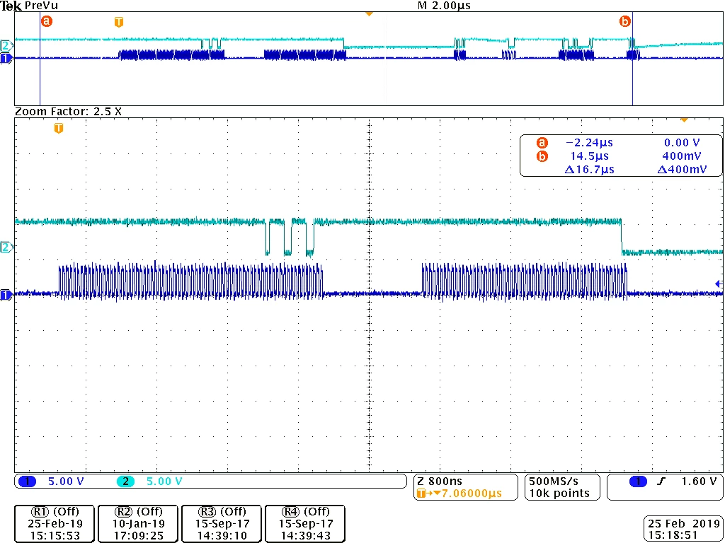

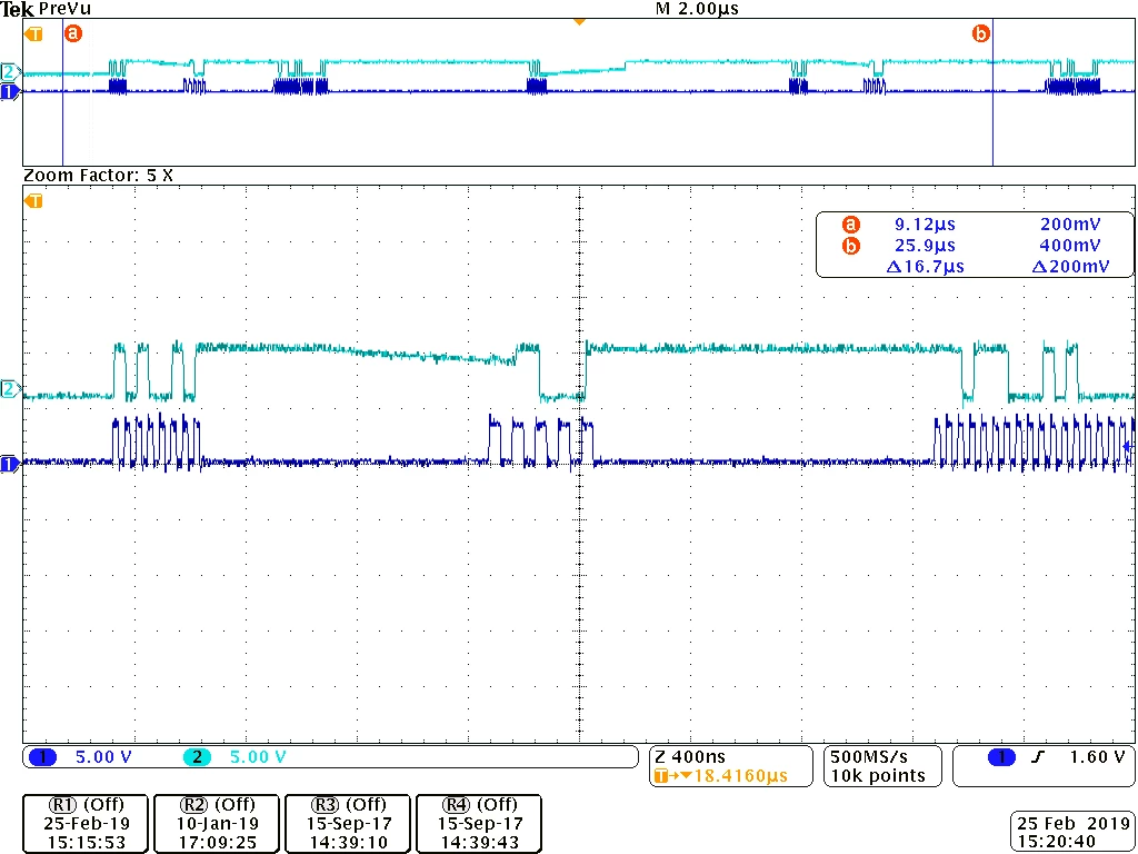

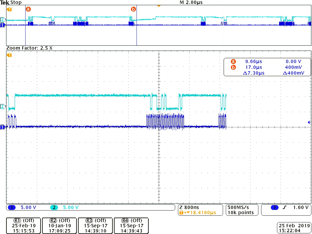

Here some code extract to give you directions:
I used this link to get baseline: https://www.cnblogs.com/shangdawei/p/4753040.html

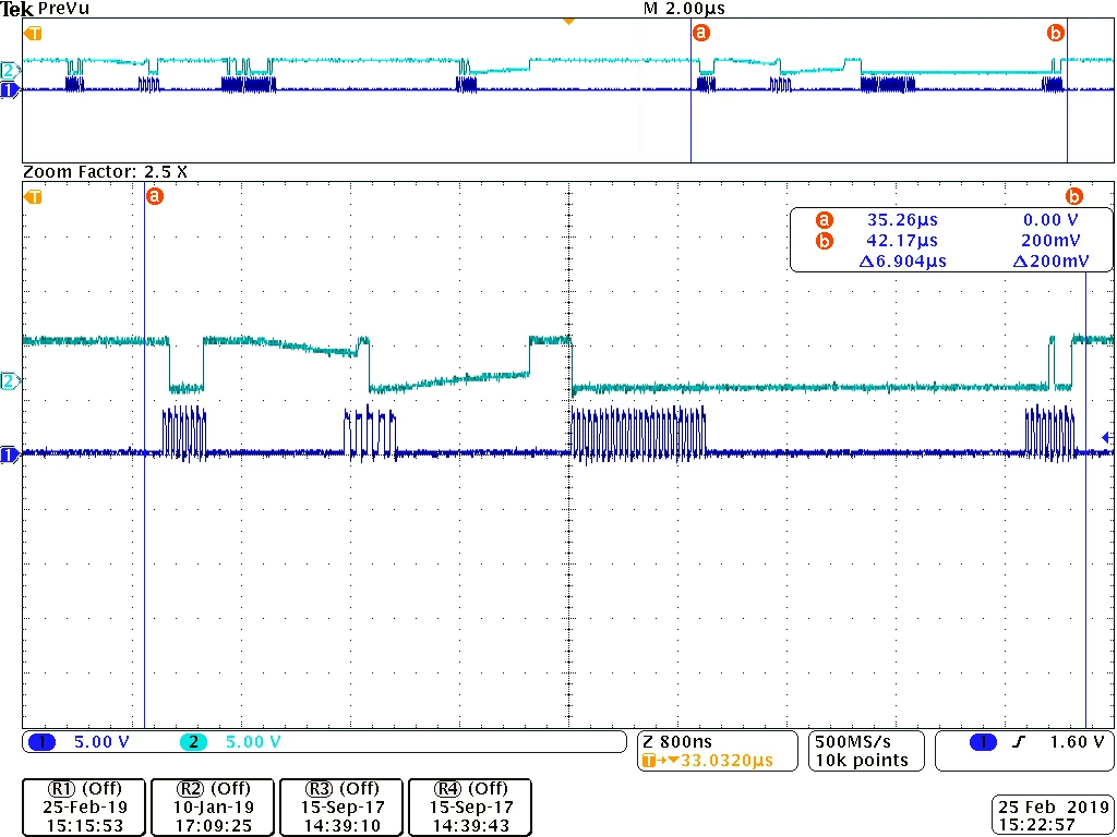

You will short MISO and MOSI outside. Here is STM32L4R5 in BGA132 @ 48MHz SYSCLK (low power) with 12 MHz SPI

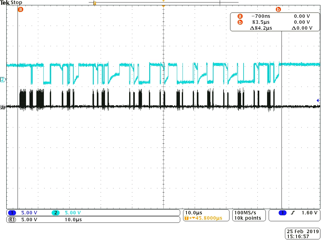

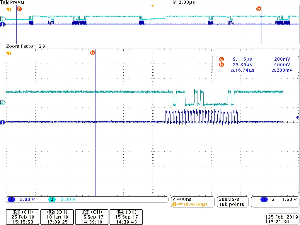

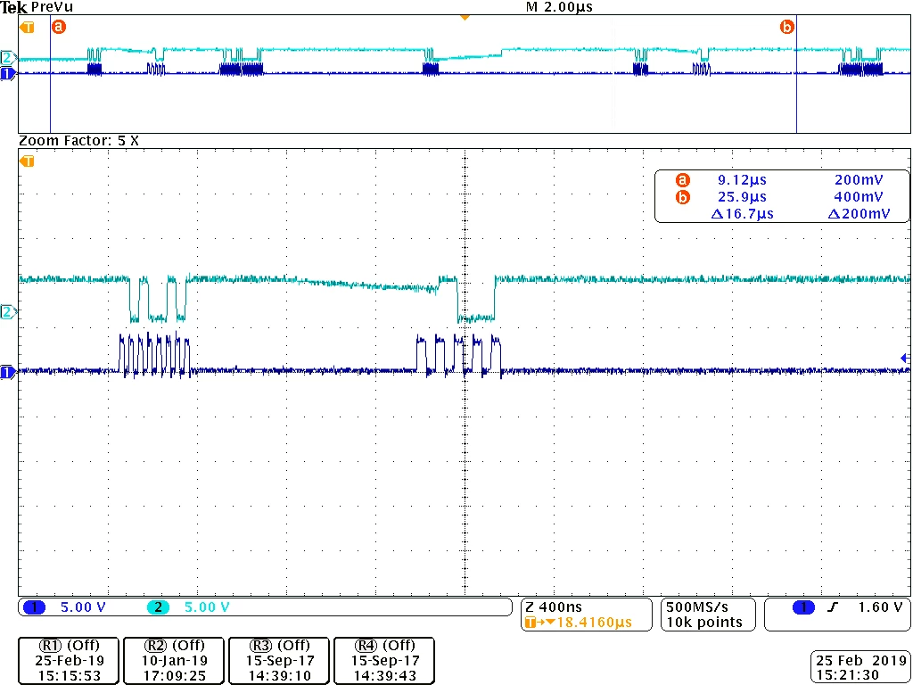

S.Ma
Principal
Dec 6, 2019 7:21 PM UTC
Part 2 (this forum can't put all in one answer...)
Then you get something like this:

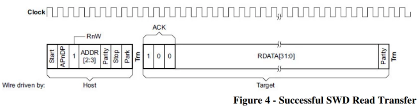

void SWD_Read(uint8_t cmd, uint32_t* pdata32) {
 uint32_t readback;
 uint8_t Regs[7];
 SWD_WaitIdle();
 FlushRxFifo();
 *(__IO uint8_t *)&SPI3->DR = cmd; // CMD transmit 8 bit
 SWD_WaitIdle();
 SWD_RxMode();
 SWD_SetSPICR1Slower();
 SWD_SetBits(5);
 *(__IO uint8_t *)&SPI3->DR = 0x99; // move 5 bits
 SWD_WaitIdle();
 readback = *((__IO uint16_t *)&SPI3->DR); // read past 8 + 5 bit
 SWD_SetSPICR1Normal();
 SWD_SetBits(8);
 Regs[0] = readback & 0xFF;
 readback >>= 8;
 Regs[1] = readback;
 SWD.Ack = (readback & 0x0E)>>1;
 SWD.du32 = (readback & 0x10)>>4;
 SWD.bitsum = SWD.du32;
 if(SWD.Ack!=0x01) { // NOK
 // error and abort
 SWD_TxMode();
 return;
 // OK, so now we read the leftover bits (lsb is captured already)
 *(__IO uint8_t *)&SPI3->DR = 0x99; // move 8 bit LSB
 *(__IO uint8_t *)&SPI3->DR = 0x99; // move 8 not
 SWD_WaitIdle();
 Regs[2] = *((__IO uint8_t *)&SPI3->DR);
 Regs[3] = *((__IO uint8_t *)&SPI3->DR);
 Regs[4] = *((__IO uint8_t *)&SPI3->DR);
 SWD_SetBits(9);
 *(__IO uint16_t *)&SPI3->DR = 0x9999; // move 8+1 bits
 SWD.temp32 = Regs[2];
 SWD.du32 |= (SWD.temp32<<1);
 SWD.bitsum ^= NibbleBitCounter[(SWD.temp32>>0) & 0x0F];
 SWD.bitsum ^= NibbleBitCounter[(SWD.temp32>>4) & 0x0F];
 SWD.temp32 = Regs[3];
 SWD.du32 |= (SWD.temp32<<9);
 SWD.temp32 = Regs[4];
 SWD.du32 |= (SWD.temp32<<17);
 SWD_WaitIdle();
 Regs[5] = *((__IO uint8_t *)&SPI3->DR);
 Regs[6] = *((__IO uint8_t *)&SPI3->DR); // turnaround bit included
 SWD_SetBits(8);
 SWD_TxMode();
 // we rebuild all decoded values
 SWD.temp32 = Regs[5];
 SWD.du32 |= ((SWD.temp32&0x7F)<<25);
 SWD.bitsum ^= NibbleBitCounter[(SWD.temp32>>4) & 0x0F]; // includes parity bit
 SWD.parity = (SWD.temp32 & 0x80)>>7;// optional
 // calculate the parity bit
 //if((SWD.bitsum)/*||(SWD.du32!=0x2BA01477)*/)
 // NOPs(1);
 *pdata32 = SWD.du32;

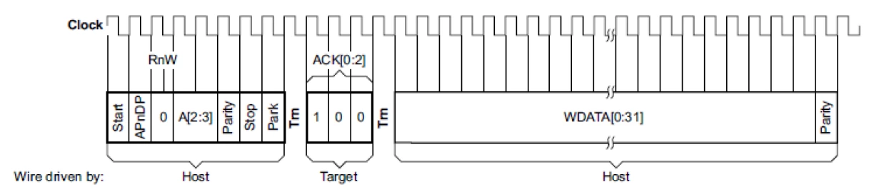

void SWD_Write(uint8_t cmd, uint32_t data32) {
 uint32_t readback;
 SWD_WaitIdle();
 FlushRxFifo();
 *(__IO uint8_t *)&SPI3->DR = cmd; // Transmit CMD 8 bit
 SWD_WaitIdle();
 SWD_RxMode();
 SWD_SetBits(5);
 *(__IO uint8_t *)&SPI3->DR = 0x99; // send 5 bits = Tn ACK Tn
 SWD_WaitIdle();
 readback = *((__IO uint16_t *)&SPI3->DR); // read the answer
 SWD_SetBits(8);
 SWD_TxMode();
// SWD.Regs[0] = readback & 0xFF;
// SWD.Regs[1] = readback >> 8;
 SWD.Ack = (readback >>9) & 0x07;
 NOPs(1);
 // error and abort
 return;
 *(__IO uint8_t *)&SPI3->DR = (data32 >>0) & 0xFF; // send 8 bit (hopefully)
 *(__IO uint8_t *)&SPI3->DR = (data32 >>8) & 0xFF; // send 8 bit (hopefully)
 *(__IO uint8_t *)&SPI3->DR = (data32 >>16) & 0xFF; // send 8 bit (hopefully)
 // Here we prepare the data to transmit Regs[2..3..4..5]
 // LSB to MSB
 SWD.temp32 = data32;//SWD.Regs[2] | (SWD.Regs[3]<<8) | (SWD.Regs[4]<<16) | (SWD.Regs[5]<<24);
 SWD.bitsum = NibbleBitCounter[(data32>>0) & 0x0F];
 SWD.bitsum ^= NibbleBitCounter[(data32>>4) & 0x0F];
 SWD.bitsum ^= NibbleBitCounter[(data32>>8) & 0x0F];
 SWD.bitsum ^= NibbleBitCounter[(data32>>12) & 0x0F];
 SWD.bitsum ^= NibbleBitCounter[(data32>>16) & 0x0F];
 SWD.bitsum ^= NibbleBitCounter[(data32>>20) & 0x0F];
 SWD.bitsum ^= NibbleBitCounter[(data32>>24) & 0x0F];
 SWD.bitsum ^= NibbleBitCounter[(data32>>28) & 0x0F];

S.Ma
Principal
Dec 6, 2019 7:37 PM UTC
Some pictures
So to have a even fast communication, the SPI should have a special mode where the data register is split in MSB = bit length with R/W, LSB = data bits
Then the delay between packets could be minimized and average speed improved further. A true 3 wire interface would save 1 GPIO unless voltage shifting required outside.
