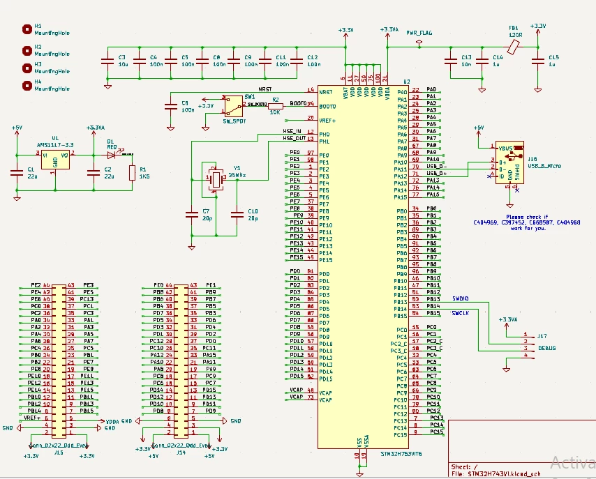

I have a simple STM32H753VIT6 board with simple power circuitry and USB connection also 25Mhz xtal.
I can program the board in DFU mode and verifies fine. I do not have the LSE xtal. not sure if it is needed for the USB operation. Complete circuit diagram attached. Can any one help me why am I failing with such a simple board.

Thanks for quick reply, I am a retired hobiest. Based on rule of thumb experience is the circuit ok, do I need LSE xtal for usb functionaliy. I know the debug port pins are wrong. But power circuit and all seems to work but not USB except during DFU mode.

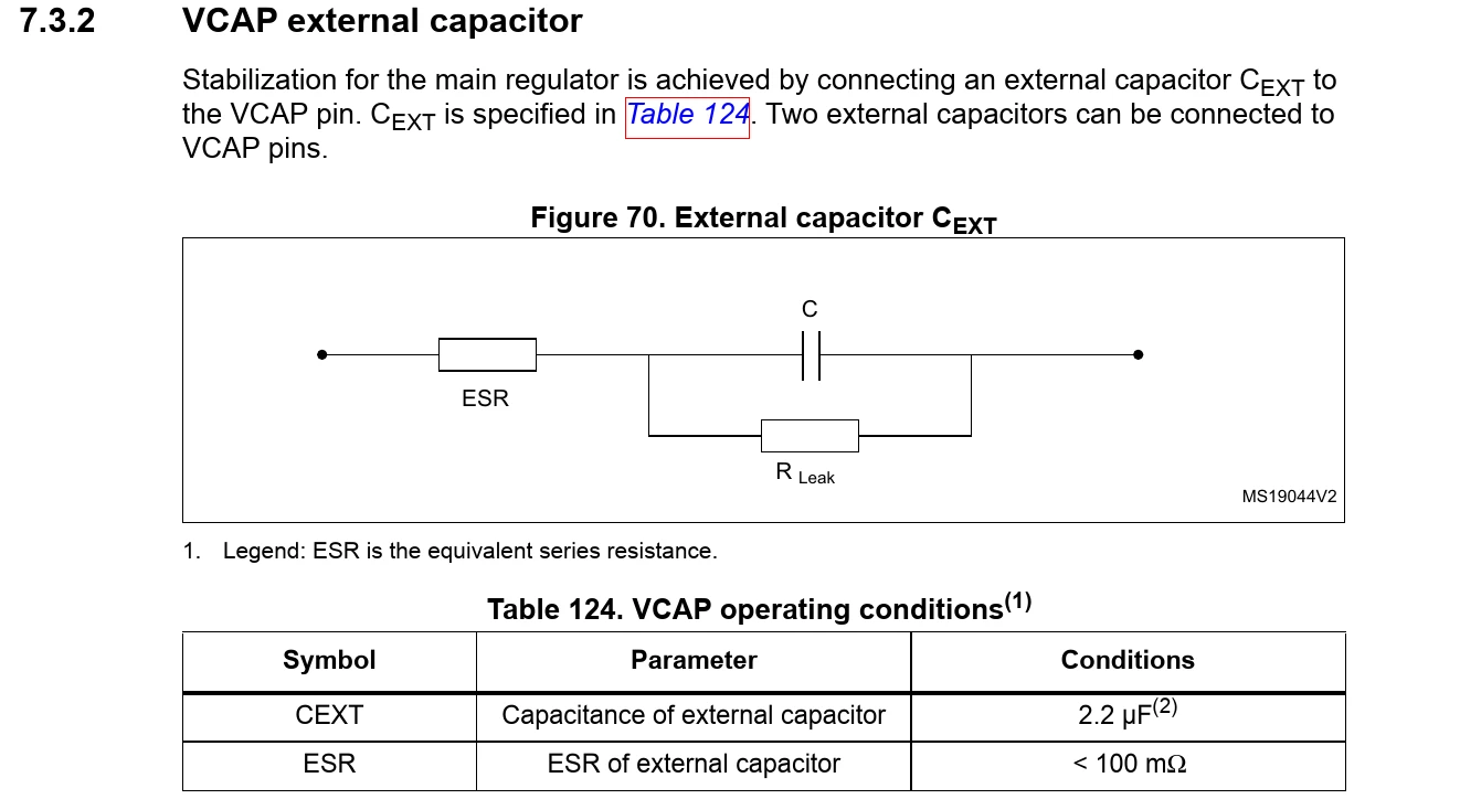

Just - whats on pins VCAP , Vref+  ?

Like in the circuit diagram they are floating and not connected. Thanks for reply. This is the complete circuit diagram.

Thats wrong.
Need caps on VCAP . (core supply !)
see ds ...
Without caps...any random behavior possible... :)
Vref+ -> see manual, if you want any analog function on yor chip, like ADC ...
usually vref+ on Vdda = Vdd :

Thank you very much, I guess I have over optimized. Do I also need the second LSE xtal for USB operation. May be I should just included it any way, better safe than sorry. Just curious though. I really appreciate your answer.
