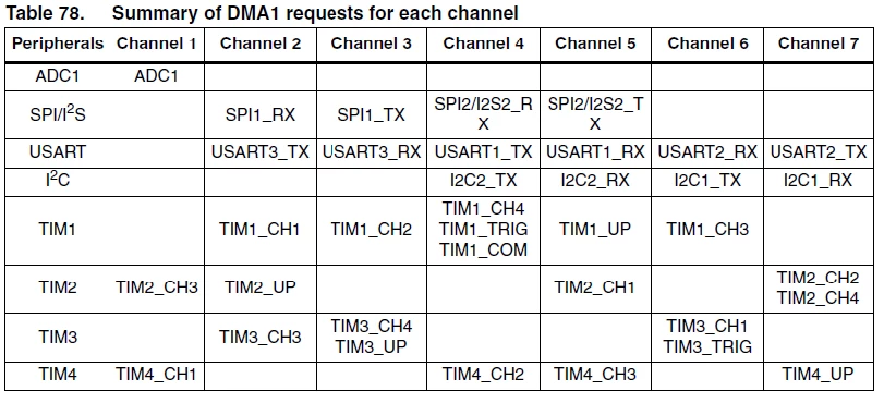

I have a problem that maybe someone can help with. I've spend the last few days on this and I just don't understand why it's not working.
I have a STM32 where I want to send out a buffer over USART 2 using DMA to a RS485 chip that sends it to a Hyperterminal via FTDI cable. I had this working using USART without DMA... by just feeding the Register with the buffer one by one. So I know that the USART and the RS485 chip works.
After inital problems i have gone to a simple example from ST Library and modified it but still can't get it to work. Here is my code.. I'm trying to continuosly send out data over USART2.
The problem: It doesn't send at all... or only once.. and usually gets stuck here:
while (DMA_GetFlagStatus(DMA1_FLAG_TC7) == RESET)
Can anyone see what I'm doing wrong?

I think it's because you need to program DMA for each transfer.
This works for USART1 on a VLDiscovery, I don't have USART2 wired up.

Thank you kind sir! You are a hero! - It works now :)
I wasted so much time on this - and i still don't understand why it's necessary to reinitialize the dma before each transmit... but it works for now.

i encountred the same problem DMA is working only with usart1 but not all channel that's why i tried all channel and it's finally working with channel6 i don't know if its a problem or a configuration range in STM
Tesla DeLorean
Guru
December 22, 2013
Posted on December 22, 2013 at 01:48
Something you'd expect to find in a Reference Manual?
From the STM32F1xx one
