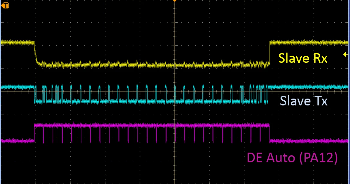

I am using STM32F303CB to build a modbus environment which connected to RS485 bus.
(BTW, MCU as slave side)
I using STM32 HAL lib to setup whole UART & RS485 setting.
I suppose DE pin waveform should be matched to Slave_Tx ( X wrong)
-> The DE pin waveform should be driven to high until Tx send out data.
The DE pin is likely a periodic pulses. (That was strange)

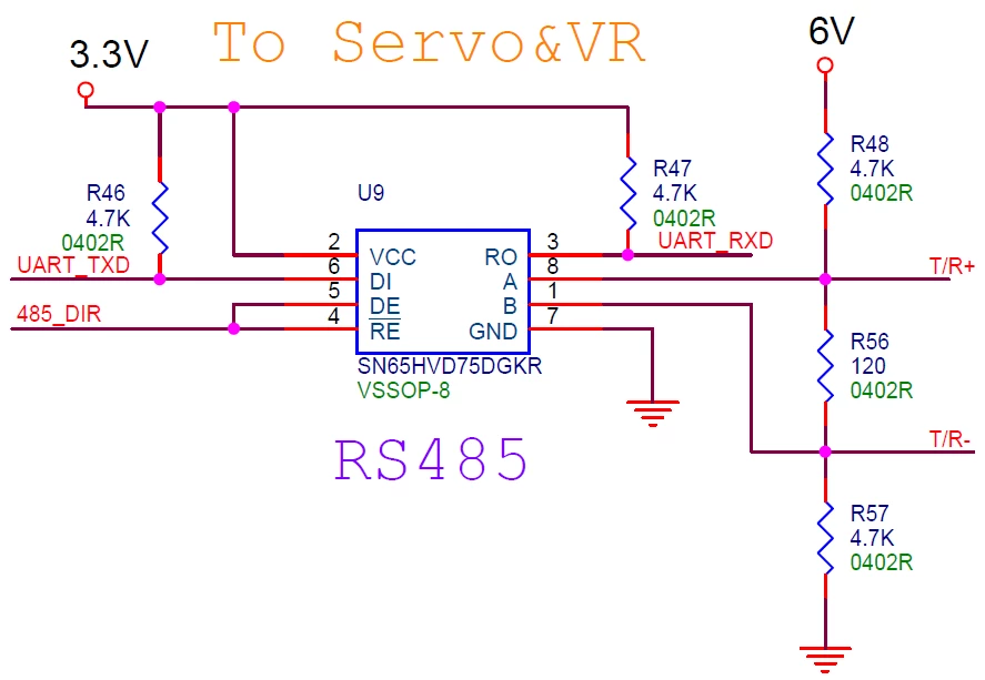

My Schematic is as follow (485_DIR = DE)

waclawek.jan
Dec 13, 2018 5:46 AM UTC
What do you mean by "match" in "DE pin waveform is not matching to salve_Tx waveform"? DE should be active during the whole duration of transmitted frames (transmitted bytes), and it appears to be so. It of course cannot be identical to Tx.
clee.10
clee.10Author
Dec 13, 2018 7:12 AM UTC
@JW Yes, you are right ( DE should be active during the whole duration of transmitted frames), even though, my DE still wrong.
clee.10
clee.10Author
Dec 13, 2018 9:28 AM UTC
I finally got the reason, cause I am using freeModbus lib, it will turn off interrupt when Rx or Tx done.
That will cause this phenomenon.
