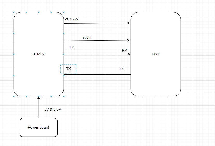

I am working with STM32g491re custom board. With UART communication our STM32 and other MCU communicating.
After flashing the firmware with debugger both boards are communicating properly but once power off & on If other board sends the data stm32 is not responding at all. Again if I flash the firmware by connecting the debugger again both boards are communicating.
UART communication I implemented interrupt communication.
Can anyone suggest what will be the reason both are communicating only with debugger.
Thanks

Tell more about these boards, how they communicate, and how they are connected.
Schematics and some good, clear photos would help.
Could it be that you're missing a ground connection, and the debugger provides that?

Hi @Andrew Neil ,
One is STM32G491RE and other is N58.Both are communicating through STM32.Data format defined for both boards.
Based on the data received from N58 ,Stm32 responds to N58.\
Schematics I can't able to share it.

If not full board schematics, at least a schematic of how the boards are connected together.

Hi @Andrew Neil ,@ Tesla DeLorean,
1.
N58: Neoway N58 is an LTE Cat. 1 module optimized specially for M2M and IoT applications
https://www.euromobile.ru/upload/iblock/8e5/Neoway_N58_Datasheet_V1.1.pdf
2. About schematic:
I know I am sorry for the inconvenience  I will check with my team what things can I share in the forum.
3.
Do the boards share a common ground?
Do the Output signals on one board go to the Input on the other?
STM32 supplies 5v supply and ground to the N58 board.
Another thing you haven't said is what debugger you're using.
Does it supply power to the board?
Debugger I am using is Segger Jlink debugger.I only connected SWD lines and ground to PC.VCC line I didn't connected to the STM32 and debugger.
My issue some how solved after giving some delay in the uart receiver callback of stm32.
Does debugger provides some delay to the programming??
Thanks

If you've got a team, it would be far better to get them involved in helping you!
People in your own team on the same project with access to the actual hardware and knowledge of the project will be far better placed to help you than complete strangers far away with no access to or knowledge of your system.
That depends on what you're doing with it.
That sounds like a flaw in your comms handling; eg, your code is not ready at the point that the modem sends stuff.
You need to debug that - otherwise it's likely to come back and bite you later ...
