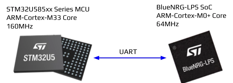

Hi, Is there any update about this topic? I am interested in learning and implementing the generic complete version of "UART Hardware Flow Control" by typically utilizing Pins TX, RX, RTS, and CTS on STM32U585xx. I also want to communicate this U5 MCU with another Evaluation board based on BlueNRG-LPS SoC as shown in the picture.
Please provide a detailed explanation and implementation resource.  I am using both HAL & LL drivers library on STM32CubeIDE and Wise-Studio IDE for this purpose.
