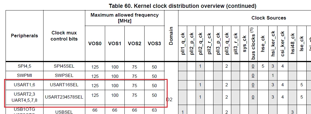

mƎALLEm
November 11, 2024
@AncoMarzio wrote:
@gbmis it possible to clock the STM32 UART at 160 MHz? Have you tried this before? Is the STM32H7 family a good fit for this test?
You didn't mention which H7 device you are referring to. But for STM32H74x/STM32H75x you cannot exceed 125MHz at VOS0 from RM0433.

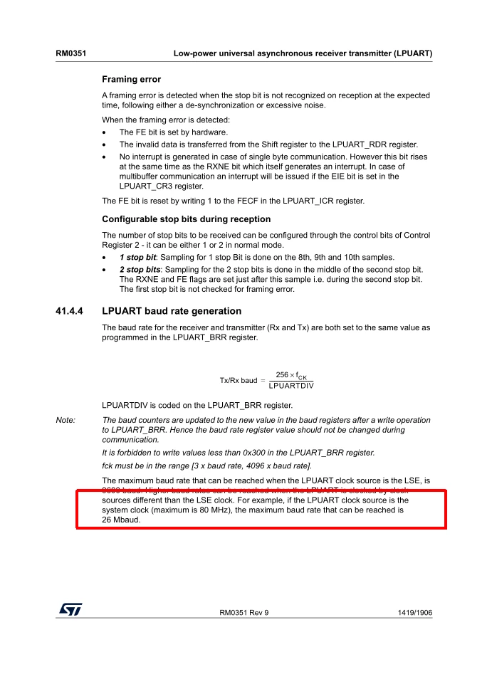

waclawek.jan
November 11, 2024
LPUART may be more flexible in achieving high baudrate-to-clock ratio, for example this is quote from the 'L4 RM:
That does not mean it's a good idea overall.
