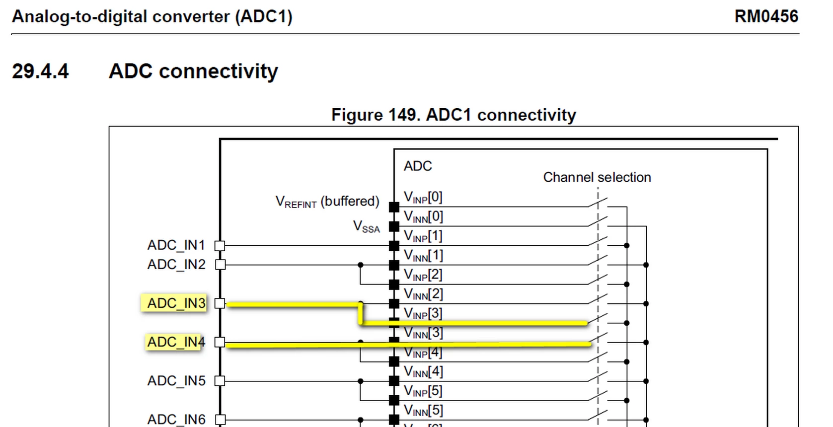

I am having some difficulty configuring STM32U575 ADC1 for Differential inputs.
The reference manual and auto-generated code seem to have conflicting information:
The ADC1 Connectivity diagram from Reference Manual (below) indicates configuring Channel [3] as differential will use ADC_IN3 to VINP (+ve) and ADC_IN4 to VINN (-ve).

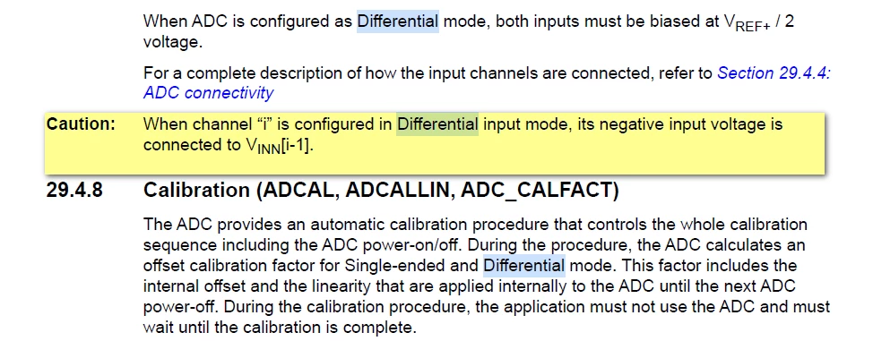

0693W00000JNRSdQAP.pngFurther down in the manual a note re: differential channels:
0693W00000JNRRzQAP.pngThe Caution note conflicts with connectivity diagram. It would suggest that when Channel 3 is configured for differential mode, then the +ve goes to VINP[3] and the -ve would go to input VINN[2].
The auto generated LL code from the IDE is another story.
The ADC init function first initializes ADC1_IN3 and ADC1_IN4. (matches the ADC connectivity diagram....so far so good)
 /**ADC1 GPIO Configuration
 PC2 ------> ADC1_IN3
 PC3 ------> ADC1_IN4
 PA2 ------> ADC1_IN7
 PA3 ------> ADC1_IN8
 PA4 ------> ADC1_IN9
 PA5 ------> ADC1_IN10
 PA6 ------> ADC1_IN11
 PA7 ------> ADC1_IN12
 PB0 ------> ADC1_IN15
 PB1 ------> ADC1_IN16
 PB2 ------> ADC1_IN17 */
 // GPIO pins Port C
 GPIO_InitStruct.Pin = LL_GPIO_PIN_2|LL_GPIO_PIN_3; // Configure input pins to ADC1_IN3 and ADC1_IN4
 GPIO_InitStruct.Mode = LL_GPIO_MODE_ANALOG;
 GPIO_InitStruct.Pull = LL_GPIO_PULL_NO;
 LL_GPIO_Init(GPIOC, &GPIO_InitStruct);
Further down in init, the channel is configured as differential input. Note that the differential mode is written to the register for ADC1_IN4. This (according to connection diagram) would be the -ve input.

Documented for helper macro LL_ADCAetChannelSingleDiff() has this note:
 *        In differential mode: Differential measurement is carried out
 *        between the selected channel 'i' (positive input) and
 *        channel 'i+1' (negative input). Only channel 'i' has to be
 *        configured, channel 'i+1' is configured automatically.
This note would indicate that the configuration should be applied to the +ve input....so the initialization code would not be correct.
Can anyone confirm if the connectivity diagram from the reference manual is correct?

I have it working now and can answer my own question for others who may have same issue:
  • The ADC1 Connectivity Diagram (Figure 149 in the stm32u575 ref manual) is correct. Use that as your guide.
  • The Caution note in section 29.4.7 of the manual is not correct.
  • Do not rely on the Cube IDE LL auto-generated code for ADC1 initialization with differential inputs...some problems there. Initializes the -ve channel instead of the +ve and also fails to initialize the PCSEL register for the channel.
