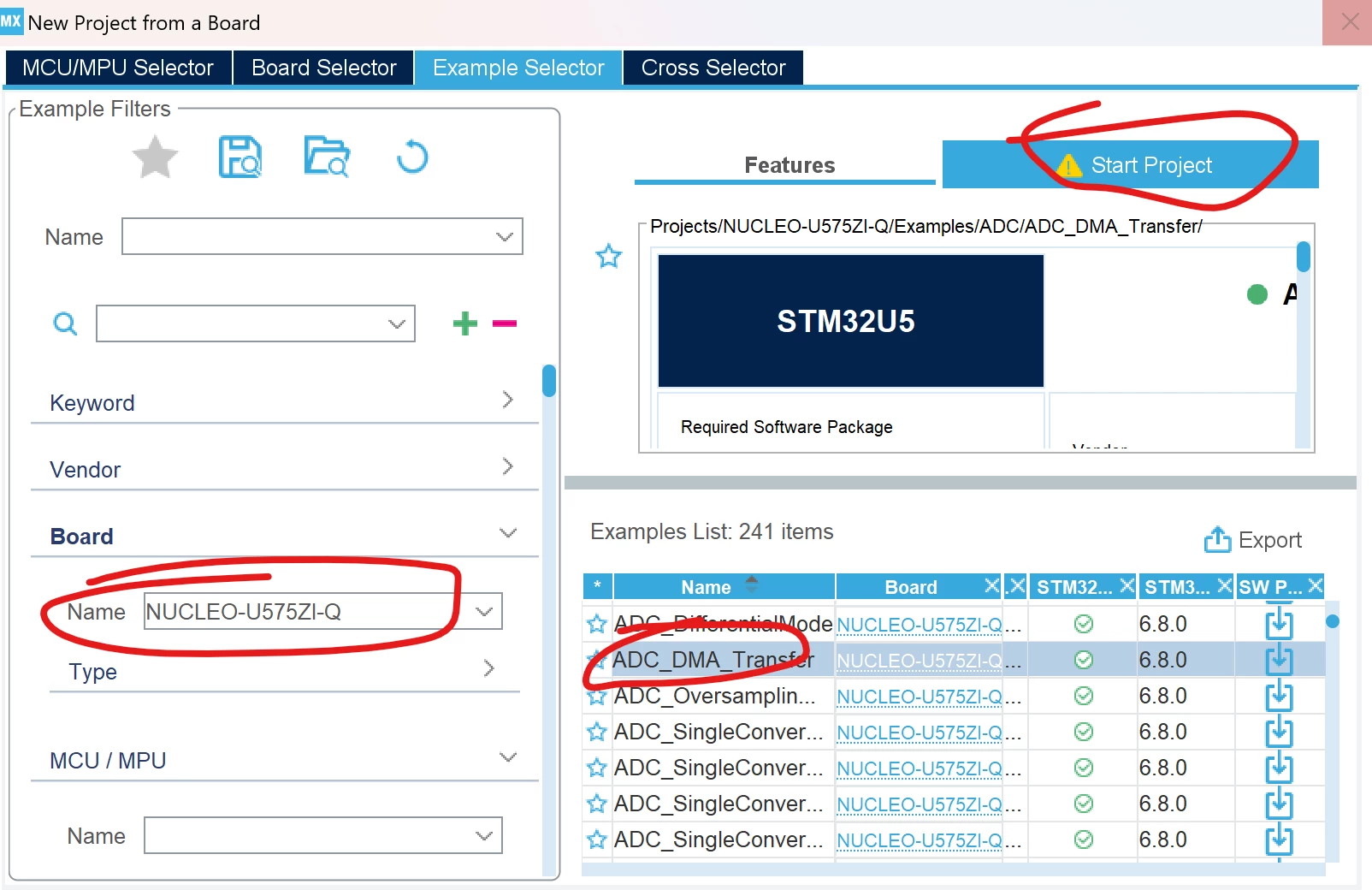

Hello everyone,
I am currently starting my master thesis and i have to design a control loop for an inverter with the STM32 U545 RE-Q. I have started programming in STM32 a week ago so everything is complicated and overwhelming ...
I am aware that there are multiple examples that i can download from every family of NUCLEOS but non of them have worked for me. I have tried the U575 example called ADC, where data from the ADC is written on the DMA, i have configured the IDE as in the example, created the Node, the Queue, etc... And i have literally copied the lines of code provided in the main.c file but it is not working.
In fact, i can not compile as there are the following errors:
../Core/Src/main.c:112:3: warning: implicit declaration of function 'MX_ADCQueue_Config' [-Wimplicit-function-declaration]
112 | MX_ADCQueue_Config();
../Core/Src/main.c:114:56: error: 'ADCQueue' undeclared (first use in this function)
114 | if (HAL_DMAEx_List_LinkQ(&handle_GPDMA1_Channel10, &ADCQueue) != HAL_OK)
I would like to configure 5 channels with the ADC4 and 5 channels with the ADC1 to monitor diverse voltage signals. Then I would like to trigger the ADC reading with
a timer with discontinuous reading as i want to have full control of the ADCs.
What advice would you give me? Has anyone ever ecountered this? How did you solve it?
If you have some examples please provide me those ...
Any help is welcomed
Marc

Feb 16, 2025 9:04 PM UTC
Starting with the example in full, before moving to something else. You need all the files to be correct/consistent, not just main.c.
STM32CubeU5/Projects/NUCLEO-U575ZI-Q/Examples/ADC/ADC_DMA_Transfer/Src/main.c at 6d33b36005af51e94604291501692cf73d7d1440 · STMicroelectronics/STM32CubeU5
The Example Selector in STM32CubeIDE can be used to load this example.
In this case you haven't modified your main.h file to include those definitions.

Lead II
Feb 16, 2025 9:52 PM UTC
Just "follow" the compiler warnings:
1. "warning: implicit declaration of function 'MX_ADCQueue_Config'":
    You call a function which is not declared. Potentially, forgotten to include a H-file or to declare this function (as available somewhere else later, e.g. via "Linker"), but a need an external declaration for the function. Here it means: you call a function which is not declared (as a "prototype"), so that compiler could check if you provide enough and correct parameters.
2. "'ADCQueue' undeclared":
    Similar: you use a data object which is not declared: the compiler has no clue what it is, what the type of the data is...
You can "use" unknown functions, but you can not use unknown data objects (therefore this error).
As TDK has mentioned:
maybe, both are there, e.g. the function coming from another C-code file (e.g. HAL driver), and the data variable defined (instantiated) in another file. But your code file does not declare both. Something missing, like an #include or an "extern" declaration.
What you could do to find the root cause:
  • Use in IDE the function "Declaration" (let's look where it is declared)
  • or in IDE "References", where it is used as well
  • Something like "go to declaration" or "go to implementation"
  • to make sure, your compiler can see as you, that it should be resolved somewhere
If you do not find it - something is missing (often a H-file to include, to declare in your file that something is "external").
On data objects: the compiler will not continue if it does not know what "it is". On a function called - the compiler warns you, that it cannot "check" if you call the function properly.
Even you can fix it via declarations of the function (as external) and the data object (as external) - the linker will complain at the end, when it cannot find one of those in any file.
Here, the compiler cannot check it what it is.
In this case, you need to add some other files to your project.
Just do what the compiler would do:
  • is it declared or defined in all the files your project will use?
  • if it is declared - do you use the file where it is declared?
  • use a "grep" tool to find where are these functions, data objects, defined AND declared
  • check, if you use all these files, e.g. adding more #include <file> files or adding more (external) C-code files to your project
