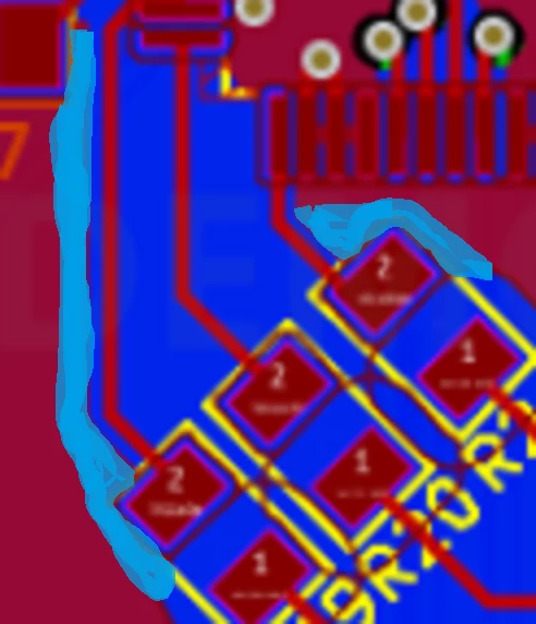

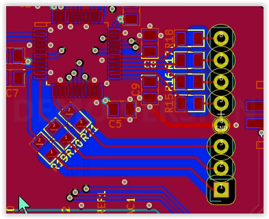

When implementing touch sensors, can I use the PCB silk screen as "panel", i.e. omit the glass/plexiglass panel?
It is for a private project, the unit will be infrequently used in lab environments.
Obviously there are issue like silkscreen and silkcreen print wear (which might be disregarded for the intended use case), but would it basically work?
Any experiences or caveats are highly appreciated.
