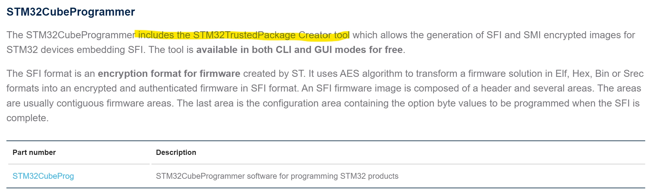

Yes, it's part of STM32CubeProgrammer now.
https://www.st.com/content/st_com/en/ecosystems/stm32trust/security-services.html

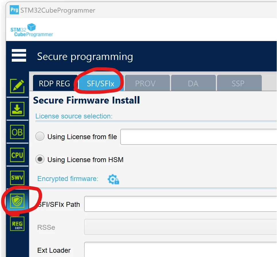

Location within STM32CubeProgrammer:

TDKBest answer
December 28, 2023

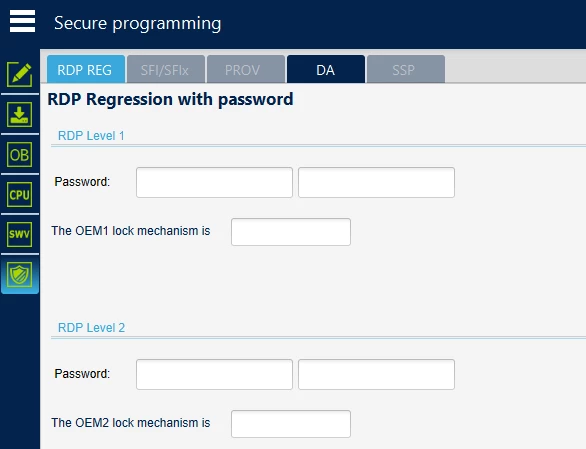

christian239955_stm1_st
August 5, 2025
Why is it grayed out? Reading AN5054 it seems, I could use  STM32 Trusted Package Creator, what apparently is this part of STM32CubeProgrammer, to create encrypted packages.
If I can only choose this tab if I'm connected to a STM32U5, STM32U0 oder STM32WBA, how can I encrypt files to be programmes onto a STM32L431 usind the STM32CubeProgrammer CLI?
STM32_Programmer_CLI -c port=COM28 -br 115200 -d out.bin 0x08000000 --key aa_myKey --iv 1b_myIv -e all -s
fails after having created the out.bin with openSSL. So I was hoping the STM32CubeProgrammer could help me...

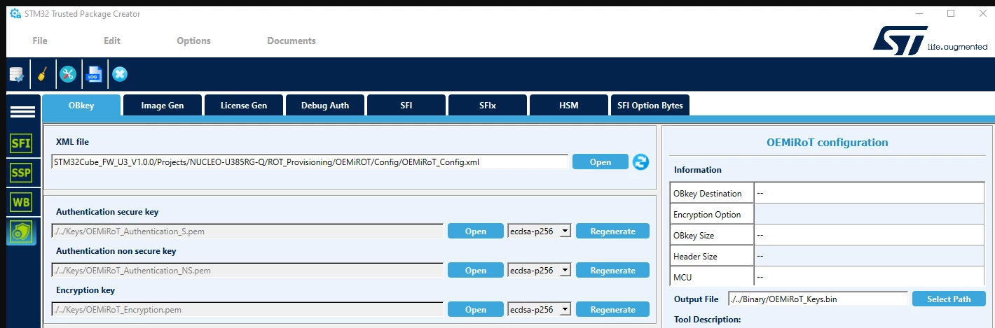

DCast.2
Visitor II
June 18, 2026
but this is a totally differente software than explained in the
https://wiki.st.com/stm32mcu/wiki/Security:How_to_start_with_OEMiRoT_on_STM32U3#cite_note-STM32Cube_FW_H5_V1.0.0-1
tutorial, I need also the  TrustedPackageCreator (TPC) packet
