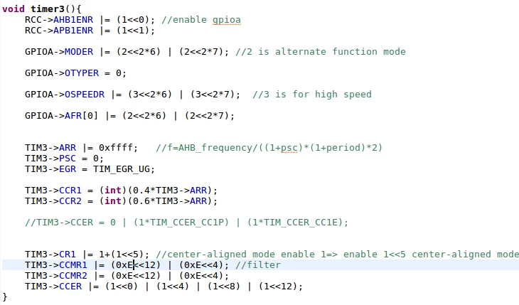

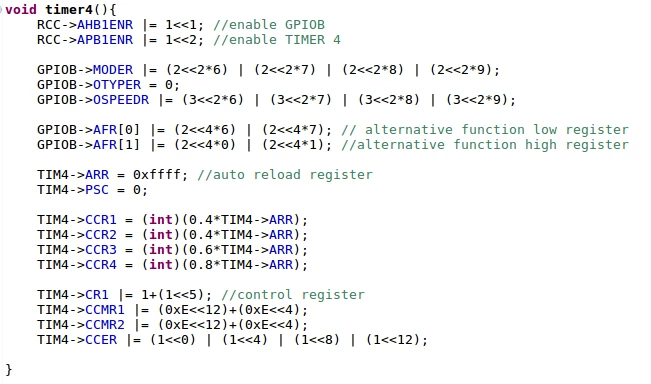

Hello, Anyone. I use the gpio timer 3 and timer 4 of stm32f4 nucleo board. And similar code, timer4 does work, but timer 3 doesn't. Can anyone help me figure out why?
