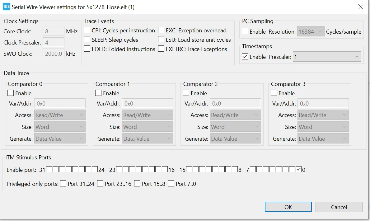

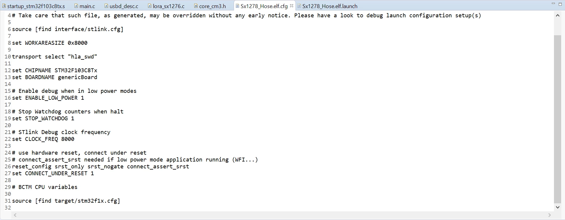

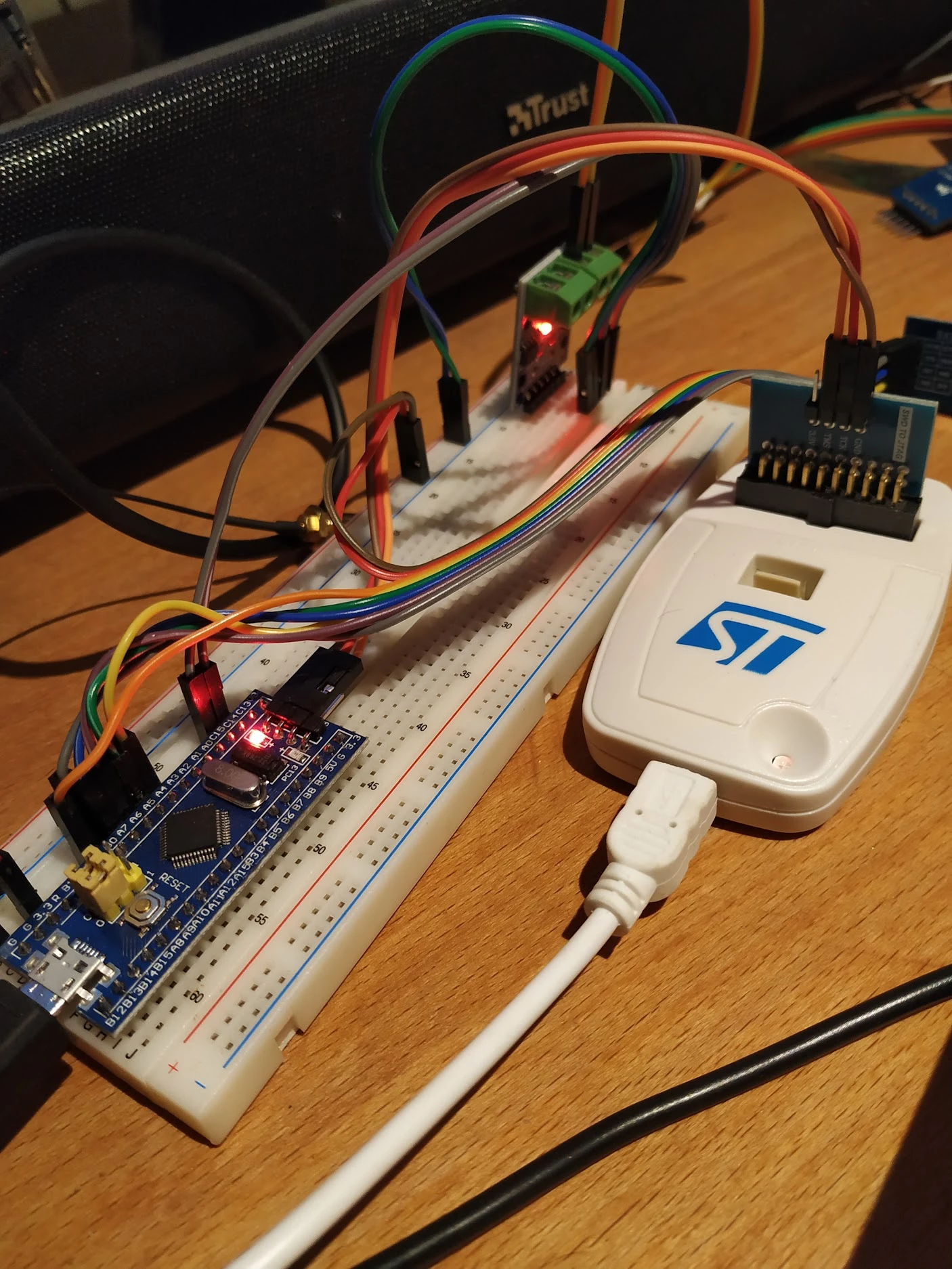

I'm new using stm32 microcontrollers, I have been trying to use the printf tracing in my code without success, anything is printed on the console . I can start a debug session, I can place breakpoints on my code, inspect variables and all works as expected but not the printf.
My setup :
0690X000009XhBTQA0.png0690X000009XhBEQA0.png0690X000009XhB9QAK.png0690X000009XhB4QAK.jpg

Core​ speed correct, really 8 MHz, not 72 MHz?
PB3/SWO pin wired?​
MPiul
MPiulAuthor
June 29, 2019
I have tried both speeds, no luck either at 8 and 72Mhz.
PB3 ? I have conected PA14 and PA13
