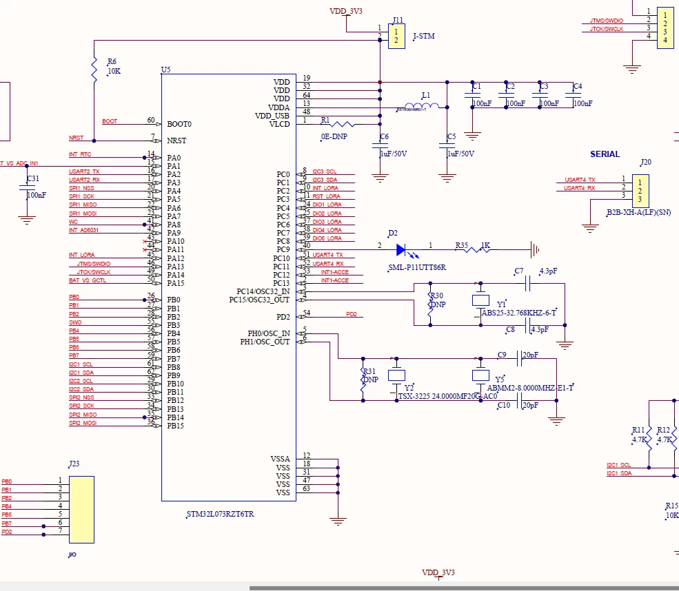

I have designed the custom board for STM32L073 series.
Initially i have tested the code/firmware in Nucleo board of same part number, and we have designed the board keeping nucleo board schematic as reference.
The code works fine in Nucleo board, but in the custom board it takes multiple reset to start the same code.
For example if i take simple GPIO toggle program in the custom board, i found in the debug session it hangs/stops at
if (HAL_RCC_ClockConfig(&RCC_ClkInitStruct, FLASH_LATENCY_0) != HAL_OK)  ,  but it works fine in Nucleo board.
In some cases when i start debug session it directly goes to HARD FAULT.
Currently i am using HSI clock source.
Kindly help me with this issue

The basic requirement of my application is that the firmware should run as soon i connect the battery/power supply, which is not happening as i have to reset the controller after i connect the power source.

Make sure BOOT0 is pulled Low

Are you sure it is actually hanging in the HAL_RCC_ClockConfig() call, or is that code  really:
 Error_Handler();
and it is actually going to the Error_Handler() - which is typically just an infinite loop?
  • If it is actually hanging in the HAL_RCC_ClockConfig() call, then step into that function and see where, exactly, it is hanging.
  • If it's going to the  Error_Handler(), then check what value HAL_RCC_ClockConfig() is returning.
But, either way, failing in HAL_RCC_ClockConfig() suggests that your oscillator is not working - so check that.
Post the schematics of your board.

August 7, 2024
VDDA should have 1 uF + 0.1 uF decoupling caps. BOOT0 should be pulled low. Otherwise schematic looks okay.
I would guess the lack of VDDA caps isn't good. Shorting the ferrite bead would be a quick hack to fix this.
What is the cause of the hard fault? Use the hard fault analyzer.
