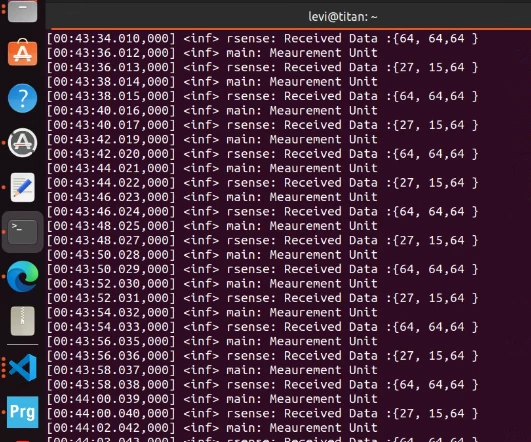

I am working on a project and I have two stm32 MCU connected over SPI interface. One acting as a master (STM32H743VIT6) and the second acting as a slave (STM32C011U6) in full duplex.
When sending data between the two devices the received data are sometimes correct and sometimes wrong.
The slave is using DMA in circular mode to receive the master data. Once received it sends back and array of 3 bytes [24, 15, 64];
Sometimes the master reading is correct and sometimes it is wrong.  Here is a capture of the received data.
If anyone has already face similar issue.
Thanks . Hope to find some solutions.

Connect analyzer or .... how speed?
sousaAuthor
November 2, 2024
Thanks for your quick response.
The running speed is  750Mbit/s.
MM..1
November 2, 2024
750 seems as mission impossible on C011 ...
