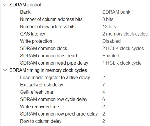

I am using STM32F469BIT6 on a custom PCB with IS42S16400J-7TLI external 8Mb SDRAM. On my previous board, I was using STM32F429ZIT6 with the same SDRAM (these mcu&sdram selected because they were used in STM32F429-DISCO) I was able to write/read data to/from SDRAM with these settings:

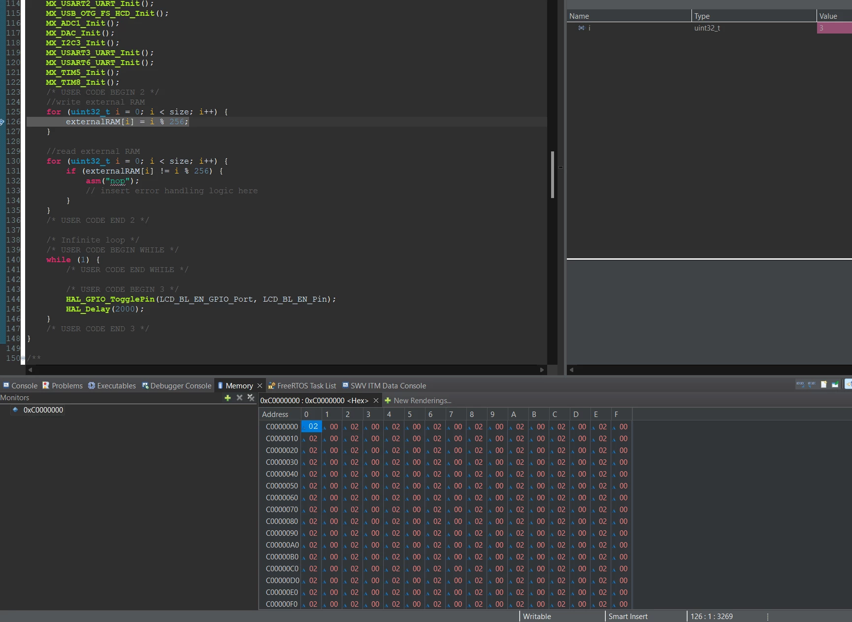

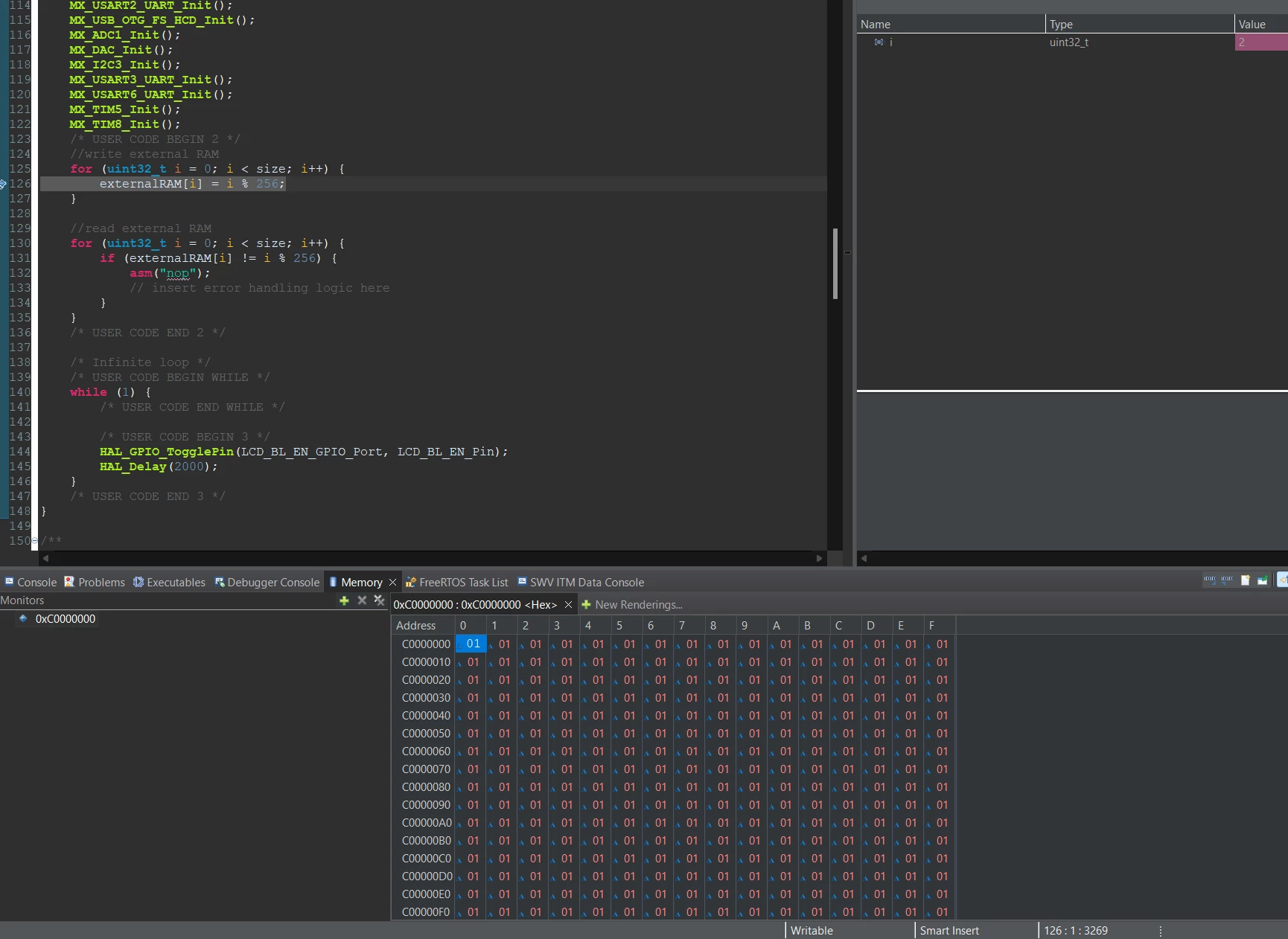

The problem is, when I try to write odd numbers (e.g. '1') to SDRAM, in the memory view, I see that all of the values are changed to "01". But when I try to write even numbers to SDRAM, only even addresses of SDRAM are changed to "02". This keeps happenning no matter the address or written data.

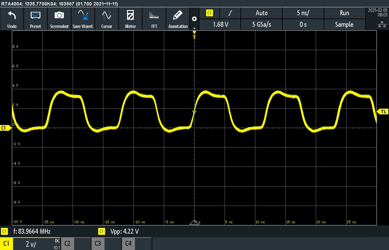

I can see clock generated on the oscilloscope:
What might be the issue here? Any help would be much appreciated.

I saw that in the initialization code I got from STM32 was incorrcet. I just copied and pasted the code. Only change I did was the refresh rate, but I did not see that it's initializing BANK2. My SDRAM bank is 1, so I wrote:
	Command.CommandMode = FMC_SDRAM_CMD_CLK_ENABLE; /* Set MODE bits to "001" */
	Command.CommandTarget = FMC_SDRAM_CMD_TARGET_BANK1; /* configure the Target Bank bits */
	Command.AutoRefreshNumber = 1;
	Command.ModeRegisterDefinition = 0;
	HAL_SDRAM_SendCommand(&hsdram2, &Command, 0xfff);
and problem is solved.
