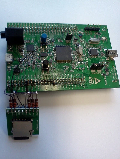

I've a problem with sdhc used with sdio in stm32f4-discovery platform. I've tried 2 versions of fat file system and sd driver, but I am not able to run sdhc properly.
The things I tried;
1) Nemui's sdio implementation with chan's fat version 0.09a.
2) stm324xg-eval implementation with also chan's fat 0.09.(which is used from stm32-demonstration builder)
Both codes are working perfectly with standard sdsc card (which are below 2gb) but when I insert a FAT32 formated sdhc card, the following occur.
1) SD_init() returns OK
2) f_mount() returns OK
3) f_open with create new file option returns OK
4) f_write returns OK with byteswritten value returned as expected.
5) f_sync returns OK
but when I connect the sdhc card to pc there seems nothings has been written.
Also there exists only one file in sdhc named as ''audio.wav'', f_open to this file returns FR_NO_FILE
the standard sdsc versions are working perfectly, the init sequence seems to support sdhc but there must be something I forget.
Can you please help me ?
Regards,
Yigit

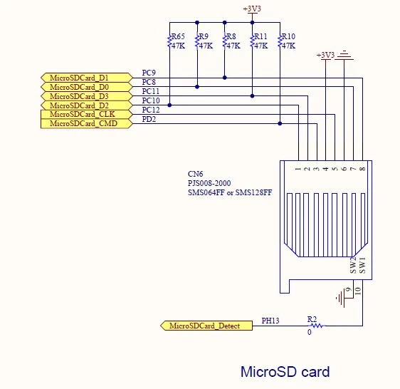

The MSC example is here, check the readme.txt for wiring details, which can also be a problem if fouled up. You need pull-up resistors.

How, specifically, do you have it wired up?
I'm using a MicroSD card socket, the signal lines are about 1'' long, with 33K pull ups. I'm using a different GPIO for the CARD DETECT pin.
yigit
yigitAuthor
Sep 13, 2012 6:36 PM UTC
Posted on September 13, 2012 at 20:36
I've connected slot as described with pullups on each line, except the clk line. I am not currently using sd_detect pin and also removed detection from the code.
I'm getting CRC errors randomly for commands that I sent. Also there is no problem with the sdsc mode. Only the sdhc mode has the CRC problem.
yigit
yigitAuthor
Sep 13, 2012 8:12 PM UTC
Posted on September 13, 2012 at 22:12
I've discovered that only 4b wide mode of sdhc has the crc problem. 1b is working fine. But I need to speed it up.
note: sdsc mode can be used in 4b wide mode without any problem. Only sdhc has the problem.

So basically an integrity issue, perhaps cross-talk, or relative skewing.
You could try dropping the SDIO bus clock, or a PCB solution with controlled path lengths/characteristics.
